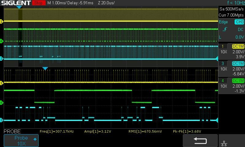

I took a snapshot of the display control.
The yellow signal is for SCL, the green is for D / C and the blue is for SDA.
ST7789_TEST.fcfx
(9.9 KiB) Downloaded 725 times
You can see that the MCU data output and the LCD drive data output are sometimes active at the same time, which does not seem to be correct.

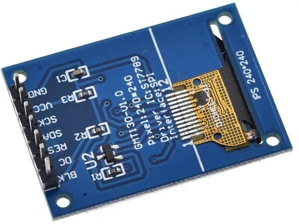

Do you have a link to the specific display you're using so we can see how it's configured.
Sasi
Posts: 134
Joined: Wed Dec 02, 2020 12:11 pm
Has thanked: 43 times
Been thanked: 15 times
Re: ST7789 component bug
Post by Sasi »
Hi Ben,
I have a few pieces of this type.
I hope there is correct data on the PCB. :roll:
Thanks:
Sasi

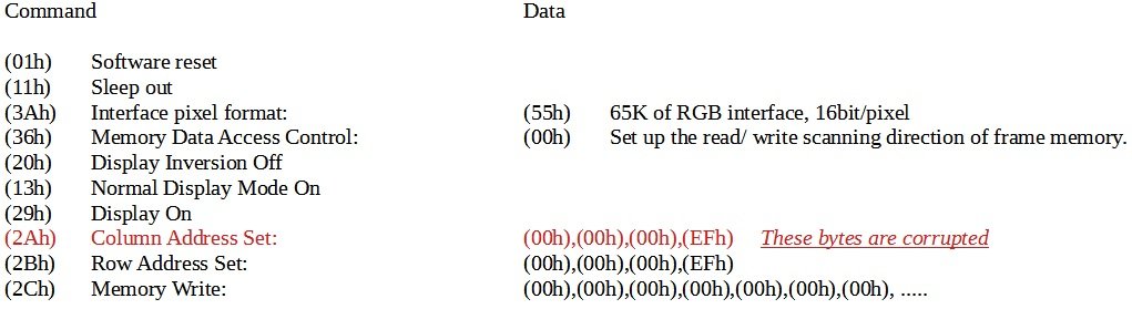

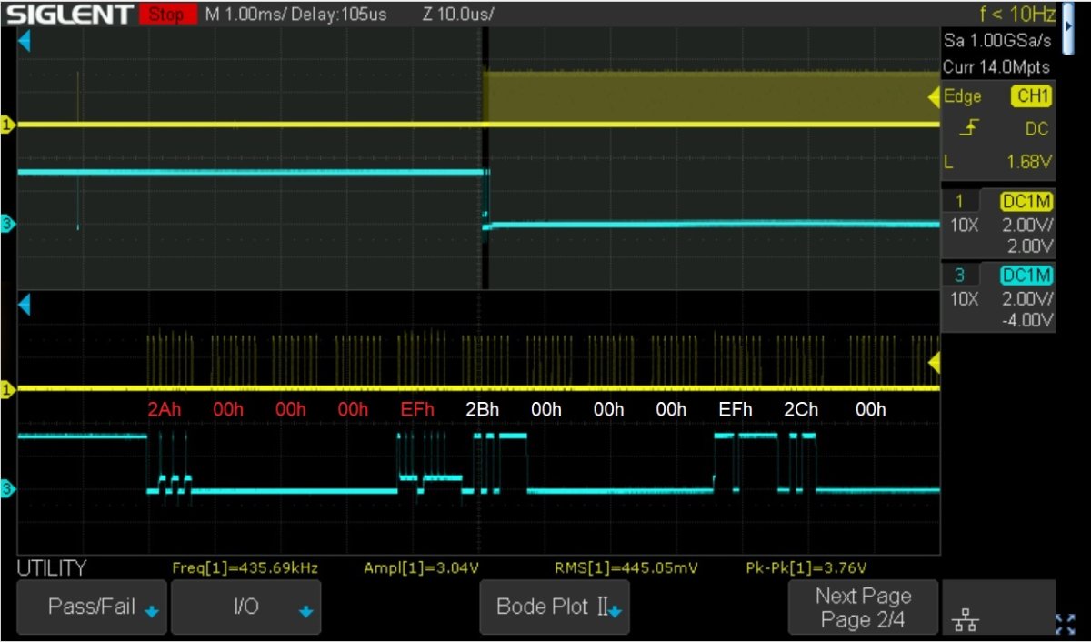

I also tried it with PIC18F27Q10 MCU. I used only the "Initialise" command of macro.
The problem is same as before.
This happened on the data line after a Reset:
ST7789_TEST_Q10.fcfx
(8.77 KiB) Downloaded 743 times
The beginning of the second (EFh) byte is not perfect either.
I hope I could help you.

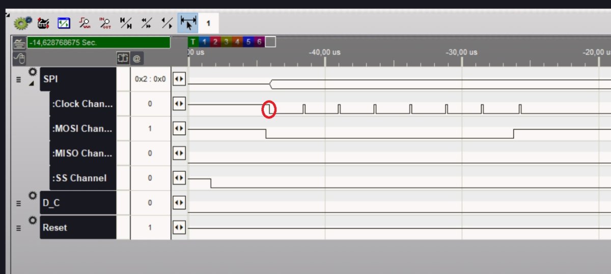

I think I found a possible cause of the error.
In the Initialization macro, the clock signal starts from a high level when the MCU sends the first byte to the LCD module. (01h, Software reset)
A rising edge is missing to write the MSB bit of the first data byte. The first data byte has only 7 clock pulses.
Therefore, the LSB bit of the first data byte will be the MSB bit of the second data byte.
This shift is true for the entire data stream, so both the 52h command (Read display brightness value)
and the 56h command (Read content adaptive brightness control) appear on the data line,
switching the SDA line of the LCD module to output mode.
Regards,
