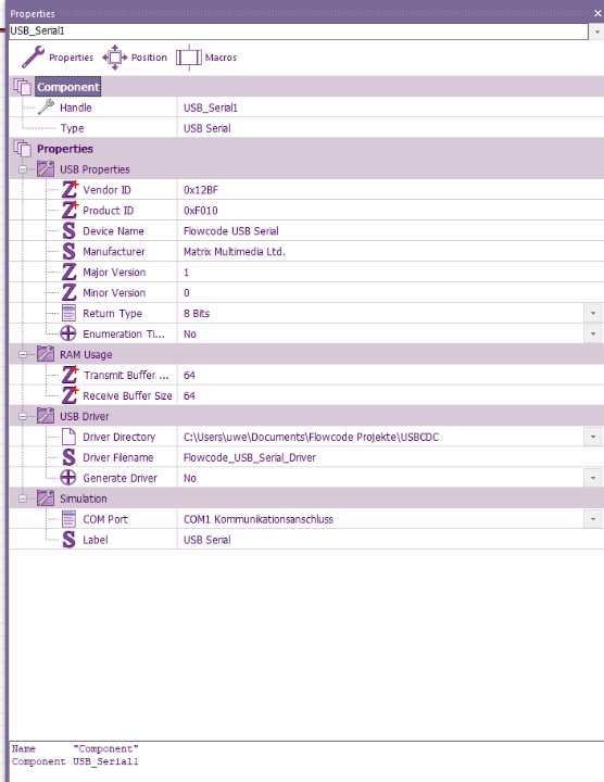

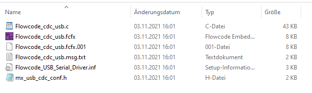

- Flowcode_cdc_usb.fcfx
- (7.91 KiB) Downloaded 566 times
- (view online)
- 03-11-2021 16-03-45.png (19.24 KiB) Viewed 4647 times
- 03-11-2021 16-02-05.png (92.46 KiB) Viewed 4647 times
