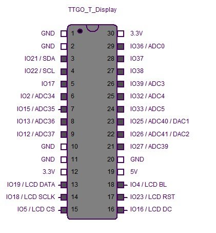

In // , I'm also working on a project with ESP32 TTGO T display.
To be able to read the battery level voltage, I need to enable the IO14 , Thx to add this IO available on the Component
TTGO display Pin IO14.jpg (34.56 KiB) Viewed 17527 times

Many thanks for letting us know. I've pushed an update to the library update system that should make this pin available for you now.

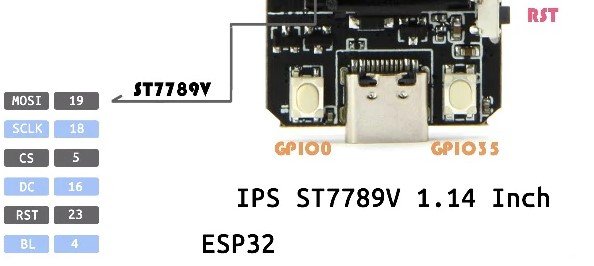

Please add the IO0 and IO35 to be able to use the 2 push buttons.
buttons and Display.jpg (26.38 KiB) Viewed 17502 times

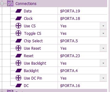

Could you also change the gLCD IO to port A like on the pictures (to be able to start new project with the good GLCD pin setup)
GLCD pin.jpg (23.7 KiB) Viewed 17502 times

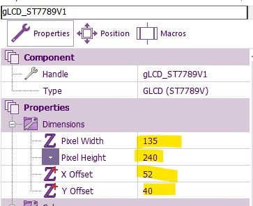

X offset and Y offset are not good and need to add offset like you can see on the picture. Could you check why please.
GLCD size.jpg (23.41 KiB) Viewed 17502 times

The X and Y offset are just down to how the rows/columns of the display has been wired to the driver IC. Is it working correctly with those settings?

Yes with these setting work well

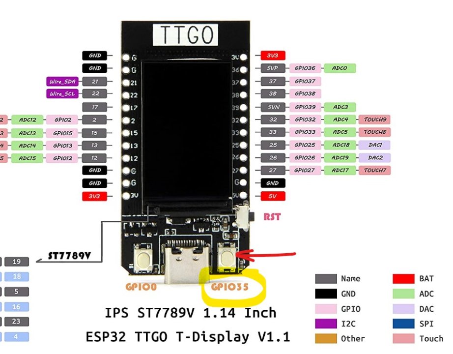

GPIO0 is working well but Pin35 is not working, I checked the complete Portb.
GPIO35 is working on simulation but not on ESP32 TTGO display
Pin0 and 35 are not available on INT too
Could you check ASAP. thx

Are you using pin 25 as an input or an output? The pin is input only on the ESP device i'm afraid if you're trying to use as an output.
There's a nice table here showing the pin capabilities.
https://randomnerdtutorials.com/esp32-p ... nce-gpios/

yes GPOI35 is only input and on ESP32 TTGO T-Display it's a switch button.
