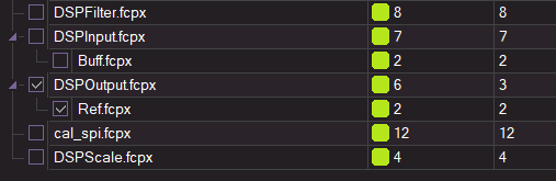

I suspect that my DSP filters will no longer work with the last update.
First I had to redraw the connection to the digital output. But then the filters deliver a wrong signal,
as if the maximum level would be. I suspect a problem with the signed long from input to filter to output

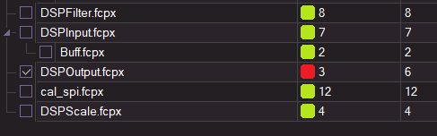

Re: DSP Filter update
Just a DSPOuput version 6 problem?
If I go back from version 6 to version 3 the DSPOuput it's working again
There is no version 4 or version 5

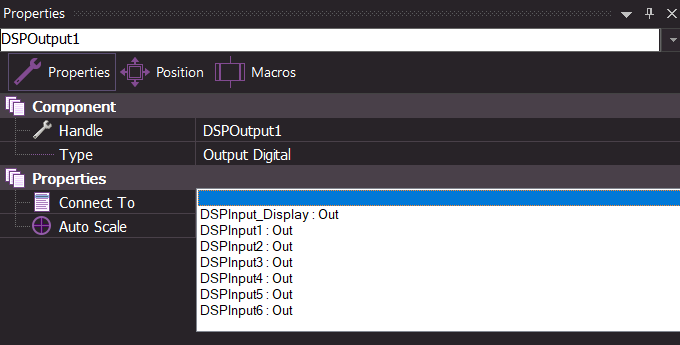

Edit I've pushed a new version of the component for you. There is a new property called auto scale, the old v3 version would have had this enabled, I've added it as a property to allow the user more control over what's going on.

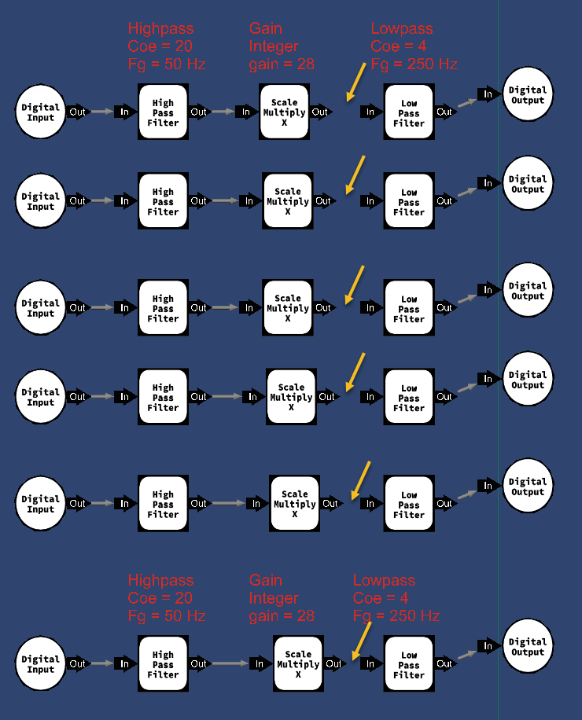

Ok. I will try that.
With the update it deleted again the connection to the filter
But there is a new problem:
connect the filter output (again) is not possible from the menue.
Thanks Stefan,
I've updated the filter component so it should be available in the list now.

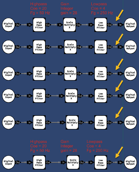

Yes it's better......but all this connection was deleted and I can not found it in the menue to connect it again.
