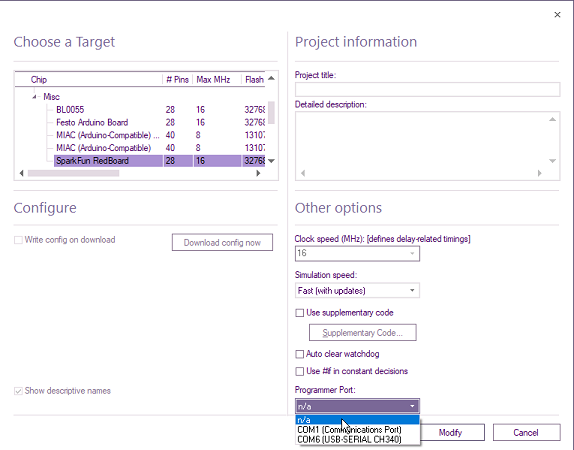

Got the driver shows up as in device manager
Com Port.JPG (12.21 KiB) Viewed 6509 times

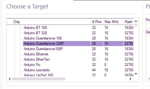

not sure what target to pic ?
is it the Duemilanove 328P ?
and
The only thing different you need to do when using Arduinos from say PICs is to set the COM port to the device within the project options.
can you explain a bit not sure what you mean

steve001 wrote:
Wed Nov 17, 2021 3:43 pm
That just means with Arduino, you need to select the correct COM port from within Project Options.
It should not be n/a:
Select Com Port.png (67.76 KiB) Viewed 6498 times
I would just try the nanao 328. So long as the chip and clock speed match the project options

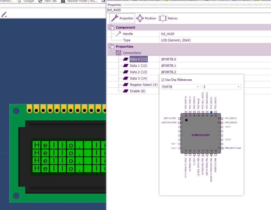

Bit Confused if somebody can point me in the right direction please
looking on the tinterweb gives this information
selecting Nano 322 as my target device
When mapping port pins flowcode shows the actual device not the nano
Screenshot 2021-11-19 152049.png (148.93 KiB) Viewed 6457 times

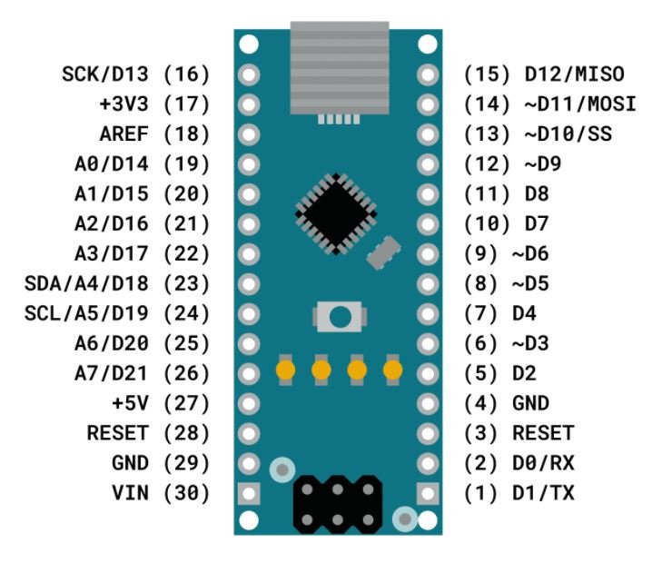

how do i know which pin is which ? - or am i missing something ?
unticking "use chip references " shows a number is this the Nano pin number ? - but this raises another question what is pin 0 ?
Steve
Posts: 2241
Has thanked: 616 times
Been thanked: 814 times
Re: Arduino Questions
Hi Steve,
When chip references is unticked pin0 = pin D0 or Pin 2 of the Nano. This matches the way the digital pins are numbered in the Arduino IDE.
