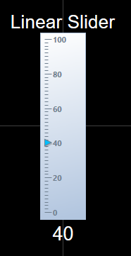

There is a Linear Slider which can be horizontal or vertical
The scale can be changed and you can have a Static Text component displaying the value.
Although the variable type for the slider is float, it will work with bytes integer, longs etc.
Linear Slider.png (12.13 KiB) Viewed 3963 times
