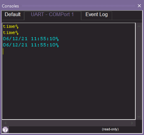

Have a small issue with APP developer
If i send a string to a com port ie "FA;"
1. It is received fine if i connect a terminal program to the comm port ie FA; is received
2 However on the flowcode console the string is shown but printed twice ie FA;FA;
Am i being thick here or is there an issue with the Console in APP developer
David

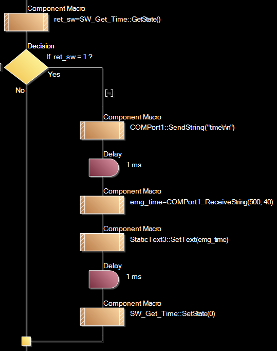

Hi Ben, Hi David
I just pressed ones the Get_Time button.
It's working fine but it shows twice in the Consoles
EMG_Setup1_2021_12_01.fcsx
(87.23 KiB) Downloaded 311 times

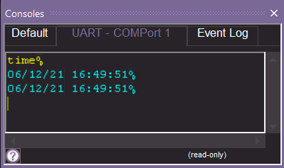

Aha thanks very much, I've spotted the replication and hopefully fixed the problem for you now.
Posts: 1300
Has thanked: 246 times
Been thanked: 258 times
Re: APP DEVELOPER ISSUE
Hi Ben, Hi David
The send data now is ok
But still double in the received data
