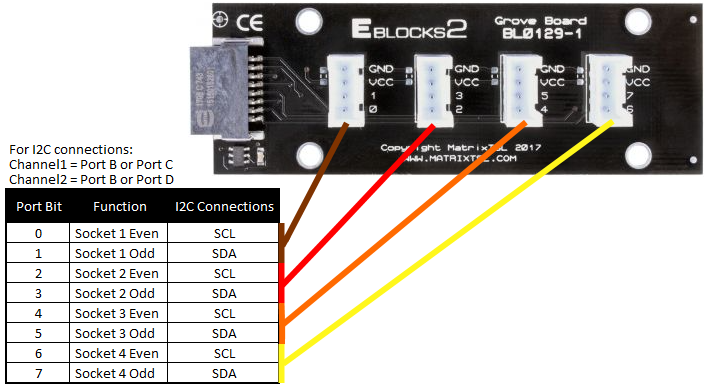

We’ve experienced some users recently who have been struggling with the Grove I2C sensors working with the MatrixTSL E-blocks2 system.
This might help:
Grove I2C Sensors Eblocks.png (162.48 KiB) Viewed 5106 times
If you are still facing issues, we are here to help.
