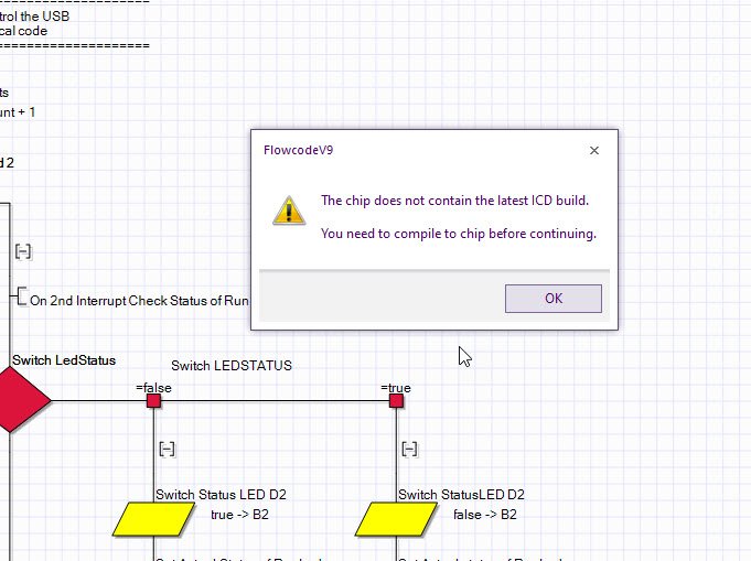

The famous Ghost error popup :D I have compiled to chip 100 times :D

That popup usually means that the Ghost and the target device are not in communication with each other.

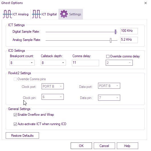

Have you got the ICD clock and data pin set in ICD settings?

The pins are set correctly RB7 Data and RB6 Clock

Ghost does not work on either EB006 or Flowkit 2 on both 25K22 and 26K22
I just tried FC8 and also no success
Thanks Leigh

We know of an issue using the INTOSC when your not using the default speed. The INTOSC will usualy start at a low speed and then be brought up to a faster speed with the C icon call.
As the chip does not start off fast the ICD comms will fail and hence the program will not start.
Is it possible to use a crystal instead while you are debugging?
If not then it is possible to add the INTOSC code to the FCDX file to force the chip to be at speed before hitting the first Flowchart icon.
