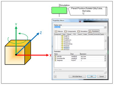

The rotation call allows an object to be rotated around any point in the target objects local Y axis. This has the effect of altering the yaw of the object - in terms of an aeroplane this makes the plane turn from side to side.
The handle must be a valid handle to a component or position, or a quoted (string) name of an object that can be selected on the panel.
The PivotHandle is an optional position to rotate around. The object will adjust its angle as though it is sliding around the edge of a circle, so at 180 degrees the object will appear 'upside-down' in the same way as a human walking around the globe from the north to south pole.
If the Pivot is zero the object rotates around its own center.
The image to the right shows a cube with it's axis positions identified.
Calling the simulation api Panel.Position.RotateY(MyCube,MyCube,1) will rotate the object in one-degree steps along it's Y-axis as shown by the green rotation arc. To rotate the cube in a counter direction simply specify a negative number for the degrees parameter.

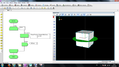

The screenshot from Flowcode v6 below shows a cuboid with it's internal axis shown (green is the Y-axis line), and also a circle that cuts right through the cuboid's Y-axis (see example section below for links to the file) When the program runs the cuboid rotates along it's Y axis.
