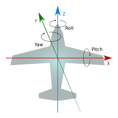

Rotation around the X axis
An object is rotated around an axis. An axis is the direction an object is facing.
If you imagine any object as a cube in shape, then aligning your view with the objects top or bottom faces is looking at the object in the Z axis, front and back is along the Y axis, and left and right sides are the X axis.
Position axis as represented in Flowcode
In the front end and API Flowcode works in Euler angles, Pitch for X, Yaw for Y and Roll for Z. Internally, Flowcode works with quaternions to increase efficiency and to work around problems like ambiguity and gimbal lock. Quaternions are calculated by rotating first around Y, then X then Z.
As convention, Flowcode represents the X axis in red, Y in green and Z in blue.

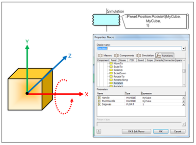

Using the properties
All the objects in Flowcode have coordinates, scale and rotation. The Properties Panel allows all of these to be changed, and rotation can be adjusted in X Y and Z angles.
Using the API
The rotation calls found in the API Panel.Position allow an object to be rotated around any point in any axis. The point rotated around is called the pivot.
Specifying any pivot other than the centre of the rotating object will alter the objects coordinates as well as its angle.
When specifying a pivot other than the objects centre, imagine a solid bar, attached at one end to a fixed pivot point, and the other to the centre of the rotating object. The rotation has the effect of rotating that bar, and therefore the object attached to the other end, around an axis.
Each rotation call can specify that pivot to rotate around, and some of the more powerful calls can also specify an axis to rotate in.
