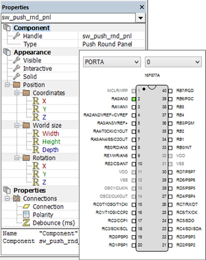

  • Click on the 'Inputs' toolbox, and locate the 'Push Round Panel' switch.
  • Hover over the image, and click on the down arrow that appears.
  • Select the 'Add to system panel' option.
  • Click on the switch on the System Panel to select it. Its properties appear in the Panel Properties.
Notice that the name ('Handle') of the component selected appears at the top of the Panel Properties.
In this case, it shows the name of the switch as 'sw_push_rnd_pnl'!
  • Find the 'Connections' properties on the Panel Properties, the box to the right of it.
A pinout of the microcontroller appears.
  • Ensure that it is connected to Port A bit 0 by using the drop down menus or clicking on the rectangle representing the pin for Port A bit 0 (called RA0/AN0 on the graphic.)
This connects the switch to Port A bit 0 of the microcontroller, matching the settings you used when you created the flowchart.
This setting is shown opposite.
  • No other properties need changing, though 'Scale' allows you to change the size (and shape) of the switch if you wish.

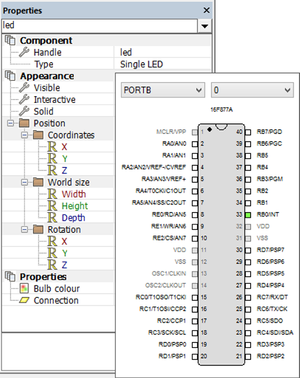

  • Click on the 'Outputs' toolbox, and locate the 'Single LED', which we will use as a lamp.
  • The LED appears in the middle of the System Panel, probably right on top of the switch.
It should already be selected, but if not click on it.
If so, drag it to a suitable position off to one side.
  • With the LED selected, look at the Panel Properties.
Notice that the 'Handle' has changed to 'led'.
The 'Connection' property may not be connected to the correctly, as the flowchart expects it to be connected to Port B, bit 0.
  • Click on the box next to the 'Connection' property and, as before, a pinout of the chip appears.
  • Click on the rectangle representing the pin for bit 0 of Port B, shown as RB0/INT or use the drop down menus to connect the component.
The Panel Properties now show that the LED is connected to Port B, bit 0.
  • Once again, no other properties need changing, though 'Scale' and 'Color' settings can be altered to change the size and color of the LED.
