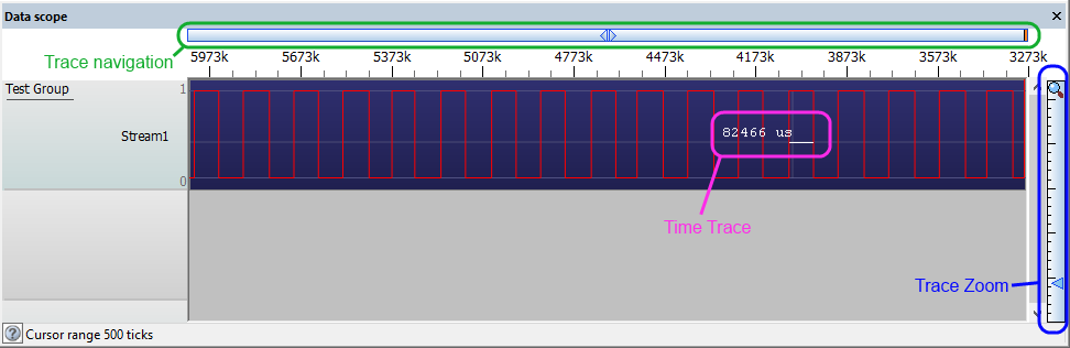

To navigate around the scope there are two key bars which you need to be aware of:
Trace Nav Bar: This is highlighted by the green box in the picture above. Click and holding the LMB (Left Mouse Button) will allow you to scroll horizontally through the trace.
Trace Zoom Bar: This is highlighted by the blue box in the picture above. Click and holding the LMB (Left Mouse Button) will allow you to zoom the trace.
Hovering your mouse cursor over the trace will show any timings between two points. You can see an example of this in the pink box above.

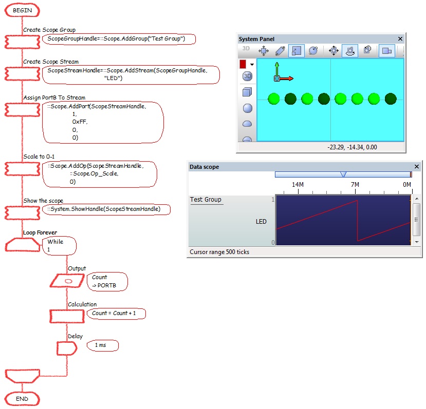

To monitor a full port with a LED Array connected to PortB we can simply call the AddPort function like this.
We then need to scale the scope channel to get the value in the range of 0-1 by calling the AddOp function like this.
Here is a simple program to generate a digital counter on the port with the signal being replicated on the scope trace. The ShowHandle function allows the Scope window to appear automatically without the user having to manually open the Scope window.
