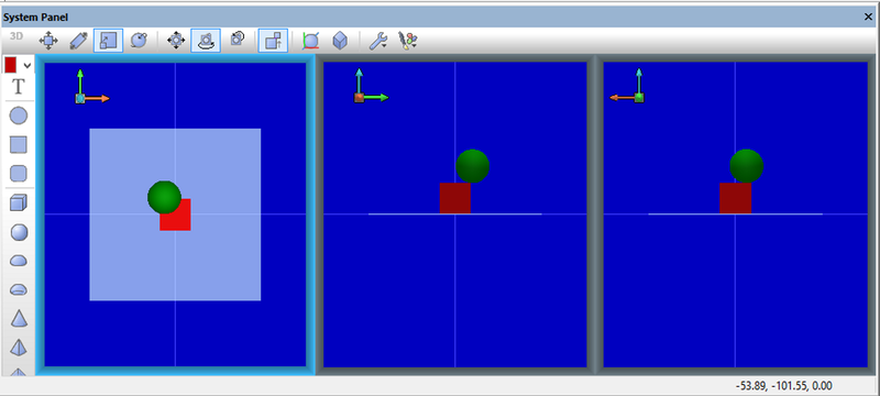

Collision type - Move through
  • Move the sphere to the start position shown.
  • Click on the 'Collision Control' icon, and select 'move through'. SHOW ICON.

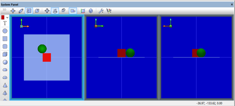

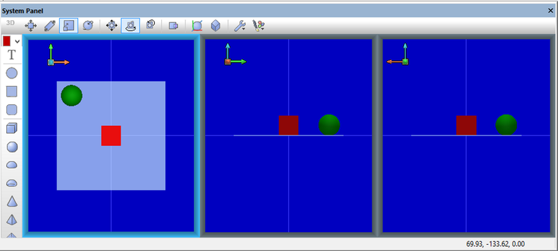

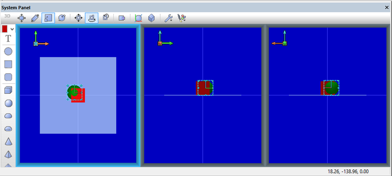

This applies when an object may enter a marked zone,
  • Move the sphere towards the cube
