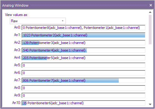

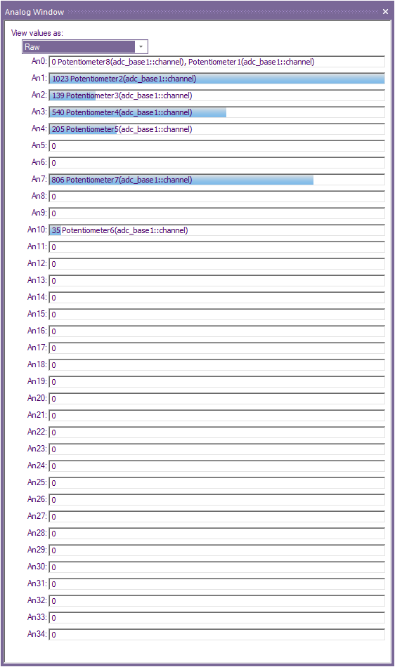

The Analog Window displays component pin connections and monitors analog values on each channel, allowing you to see if any pin connections are duplicated (e.g. An0 as can be seen in all the images), and also the results/values of each channel both as a text values and dynamic bars to display the output values of analog devices.
To open the 'Analog Window' select 'Analog Inputs' from the 'View' menu (View > Analog Inputs').

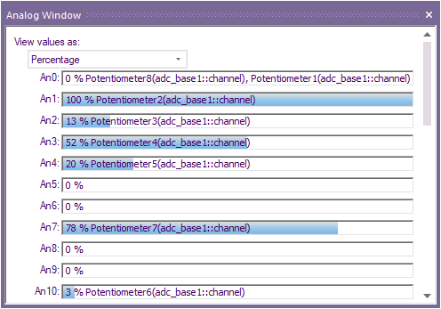

The Analog Window dynamically displays values of analog inputs and can display the data from a range of different channels simultaneously during simulation. Analog data is displayed in this window by using bars to convey the data value as well as text to accurately read the results the text can be changed to display the data as several different values/units.
You can change the 'View values as:' option at the top of the window by selecting an option from the drop-down box, by doing so you can change the text to display the data value of the analog channels as:
