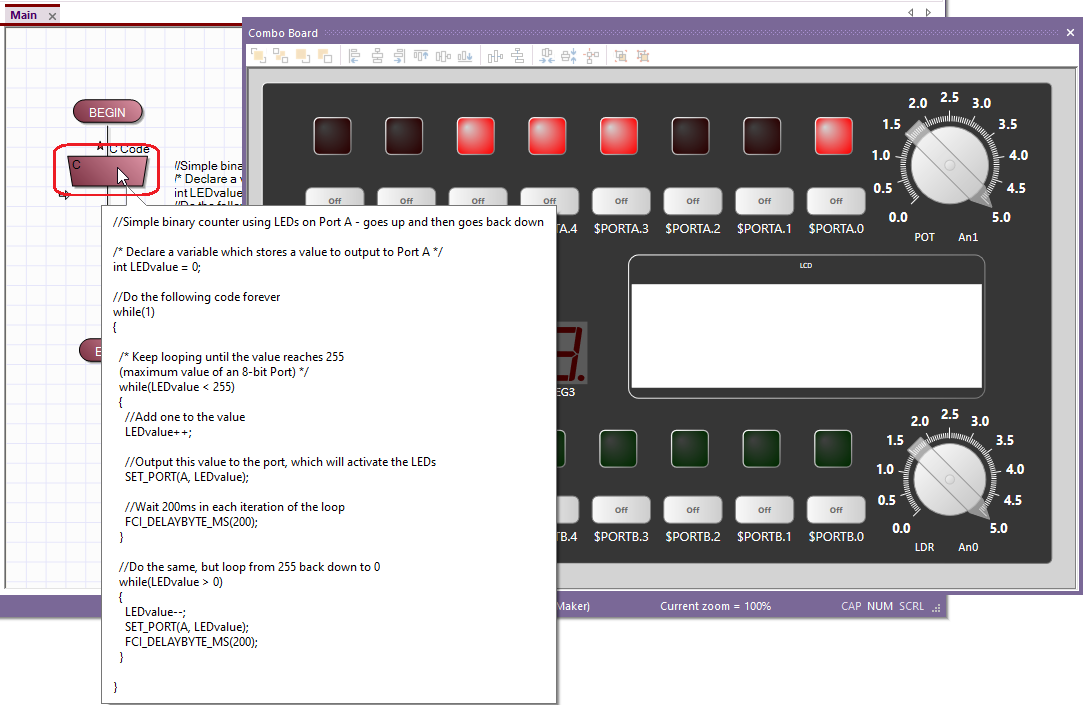

Example
Here is an example program that counts up and down in binary using Port A and a Combo Board component to show the LED signals.
The C Simulation feature is similar to the C Code to Flowchart Conversion feature that converts C code into Flowchart icons.
To view all the c code ,ither hover over the C code box as shown above, or double click on it.
