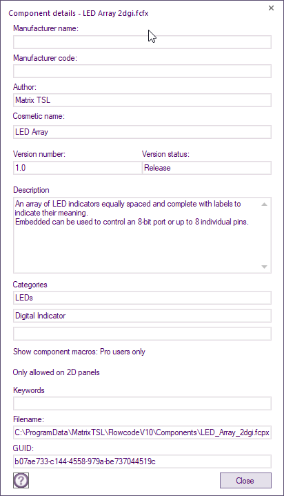

These component help files on the wiki can also be accessed from Flowcode by selecting the '?' button on the component details page.
The component details page contains the name, version number, description and guid of the component, this can be accessed by right-clicking on or clicking the arrow button next to a component in the Components Toolbar menu.
