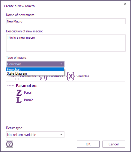

Select the 'New' option from the 'Macro' ribbon or press Ctrl+M to create a new macro.
You can also create a new macro using the 'Macros' section of the Project Explorer by clicking the arrow next to the 'Macro' item to open up a menu, then selecting 'Add new' from the menu.
Your created macros will be displayed in a list in 'Macros' section of the Project Explorer, here you can add new local variables and constants as well as parameters if you did not do so earlier, you can also delete or edit existing local variables, constants and parameters.
The Macro dialog will appear with the various options and information available to include:
Standard Features
Name
Enter a name for the macro. If the name that you enter for the new macro already exists, then Flowcode will prompt you for a different name.
Description
Enter a description of the macro and its functions. The description text will appear at the top of your macro flowchart above the Start icon.

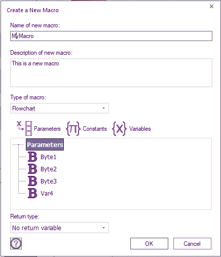

Adding multiple parameters of the same type

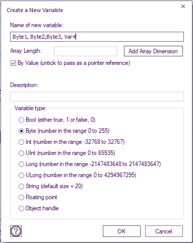

When adding parameters of certain types you can specify multiple variables at once by adding the names of the parameters with comma separated syntax.
Variable names can be separated with or without spaces
Pressing OK will allow the parameters to be automatically generated.
This syntax also works when creating local and global variables.
