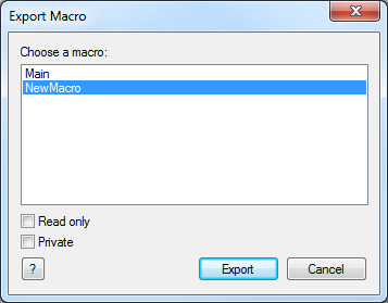

Select the 'Export' option from the 'Macro' menu (Macro > Export...).
Flowcode will then ask you to select the macro you wish to export and then ask you for a filename to save the file.
Flowcode macros are exported with the file extension .FCM
If the 'Read Only' option is checked then the exported macro will be locked and unable to be edited when importing into other Flowcode program.
If the 'Private' option is checked then the macro's code will be classed as 'hidden' when importing the macro. The code inside the macro will not be shown but the macro can still be referenced by the program in the usual way.
