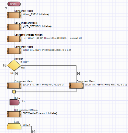

For example, if you have several icons above the main loop, e.g.:
but you are only interested in simulation within the main loop then you can group the icons you are not interested in so the flowchart will look like this:
To group the icons, hold the left mouse button down and drag the icons you wish to group together.
Right-click on the selected group and select group Icons.
You can ungroup the icons by right-clicking on the selected group and selecting Ungroup Icons.
