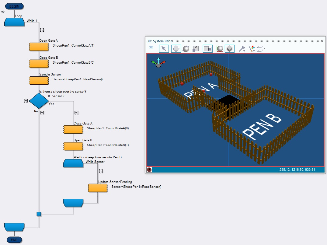

Working Example
Below you will see a working example to automatically herd the sheep from Pen A to Pen B.
