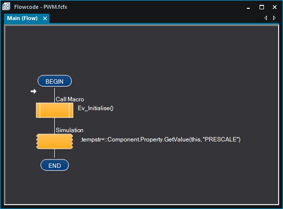

Macro tabs by default all live inside the main Flowcode application window.
By clicking and dragging on a macro tab you can now tear the window from the main application window to allow you to move the tab to a new window for use on a second monitor.
The resulting window can have multiple tabs attached in the same way as the main application window. Multiple tabs can be shown at once in a single window by dragging them to the side of a window, similarly to splitting the view in the main application window.
Tabs can be re-docked onto the main application window by again clicking and dragging the tab.
