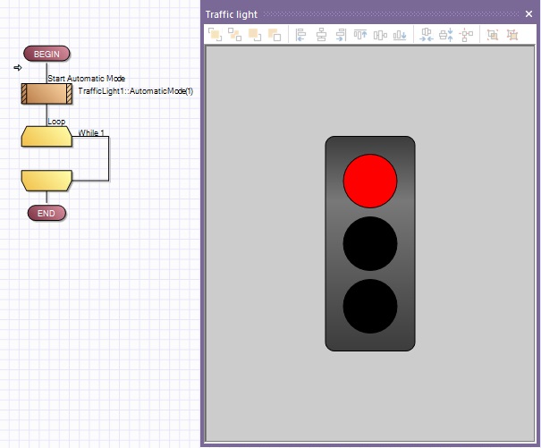

  • Create a new flowchart, and select ‘No chip’ as the target device. We choose no chip as this is a simulation only exercise.
  • Add the ‘Traffic Light 1-Way’ component to the 3D Panel, from the ’Simulation -> Scenarios’ category.
  • Adjust the 3D Panel so that you can see the traffic light, The Preset Views button or clicking the arrows at the top left of the 3D Panel window can be very helpful.
  • Add a component macro ‘AutomaticMode’ to start the lights moving through its pre-programmed light patterns.
  • Add a loop to your program to loop forever until the simulation stop button is pressed.
  • Run the simulation by clicking the Play button on the top toolbar.

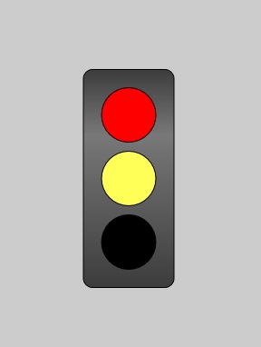

  • Take note of the different states the lights can be in.
Working Example
Below you will see a working example to monitor the light sequence of a simple 1-way traffic light.
