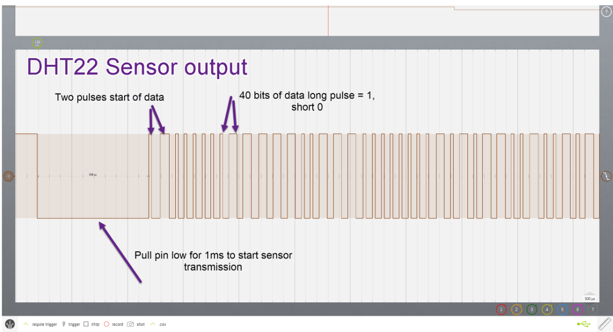

Found a DHT22 and had a play. Wired up to an esp32 and an oscilloscope - interesting trace!
I couldn't understand why pulling the pin low for 3ms (actually this only needs to be 1ms) would start a 'sensor' reading in the component - but my pulling a pin low for a period didn't (just a low for 3ms) I didn't get a reading using the component though - and wasn't sure why.
So - a little time later - I came up with this. Tested and working on an esp32 - it uses a slightly different approach to the component (making the code slightly simpler?) I also time in 10us lumps - making the delays slightly more achievable for some MCUs..
If anyone would like a play...
dht22.fcfx
(22.77 KiB) Downloaded 741 times
It's not a component (sorry) - and Temp and Humidity are saved as 10 times the actual value (so currently displaying 12.8C and 64.3% humidity which are saved as 128 and 643)
As an aside - if there is a timeout error - and less than 40 bits are received - it is necessary to check that there isn't an error before calculating temp - otherwise there is a compilation error (data may be used uninitialised) - that compiler is very neat!

Sample output from a DHt22.
