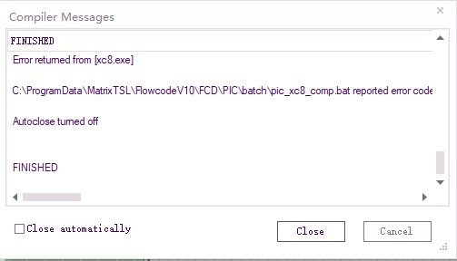

all eeprom component Compilation failure.why?

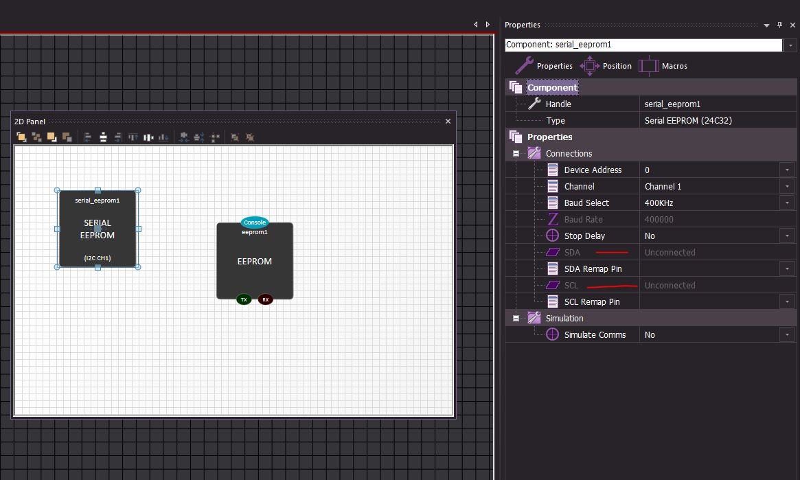

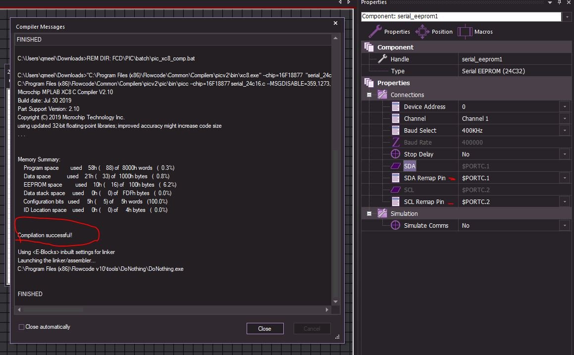

I told you once before use the help wiki when working with components !
If you do not connect the pin properies of the component the code will not compile
I connected the eeprom to mcu pins in your FC chart and it compiles fine for me
