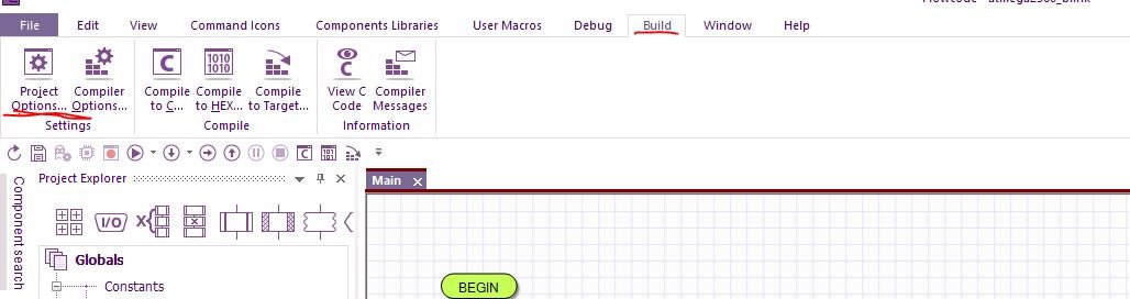

Why do you want to reinstall FC9 ,what Hardware are you using a custom build or an Arduino board?
Go to Build Project options as below
Then theconfiguration window opens you have to set the Configuration of the Mega to suit your hardware configuration

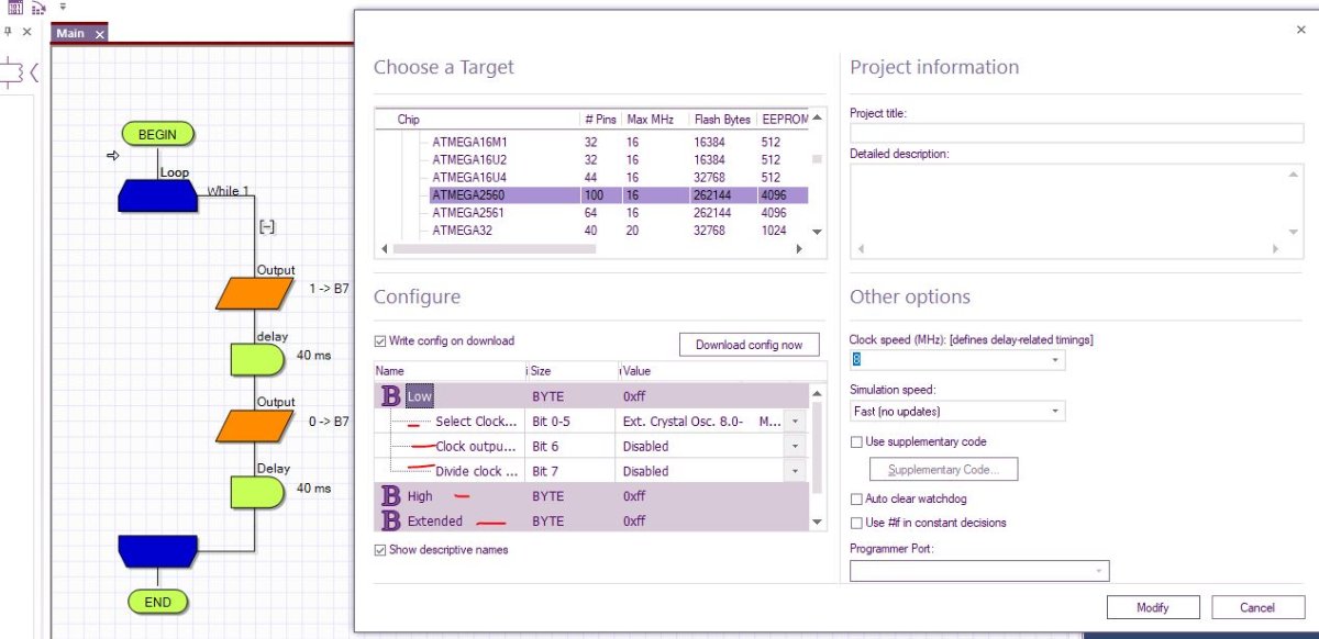

d820513
Posts: 56
Joined: Thu Aug 19, 2021 1:14 pm
Has thanked: 2 times
Been thanked: 1 time
Re: atmega 2560 flowcode9 does not work
Post by d820513 »
look
2560mega options.jpg (31.46 KiB) Viewed 9069 times
