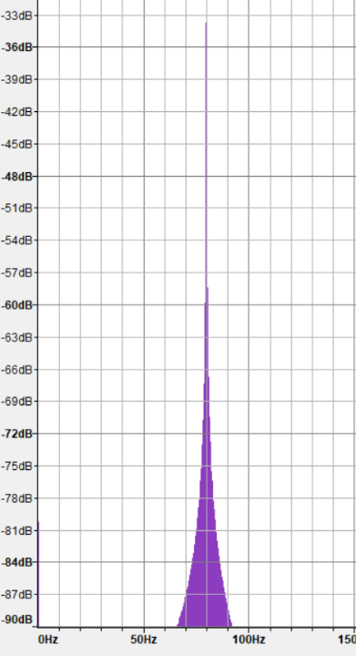

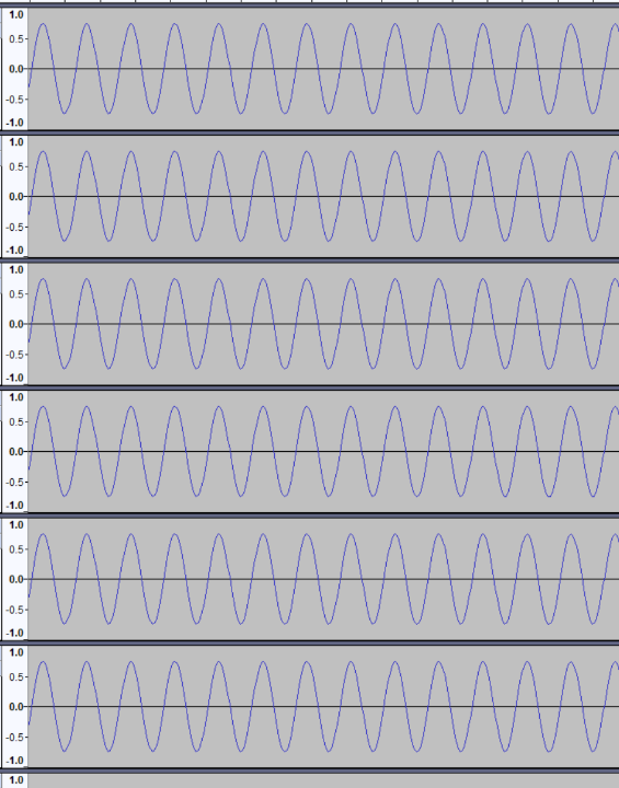

6 Channel of 8Channel, 24bit, 80hz Signal sampled with PIC32 and saved to micro SD card

I tested this new version12
and the 80Hz signal sampled with 2kHz looks good even in the spectrum.
