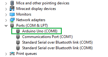

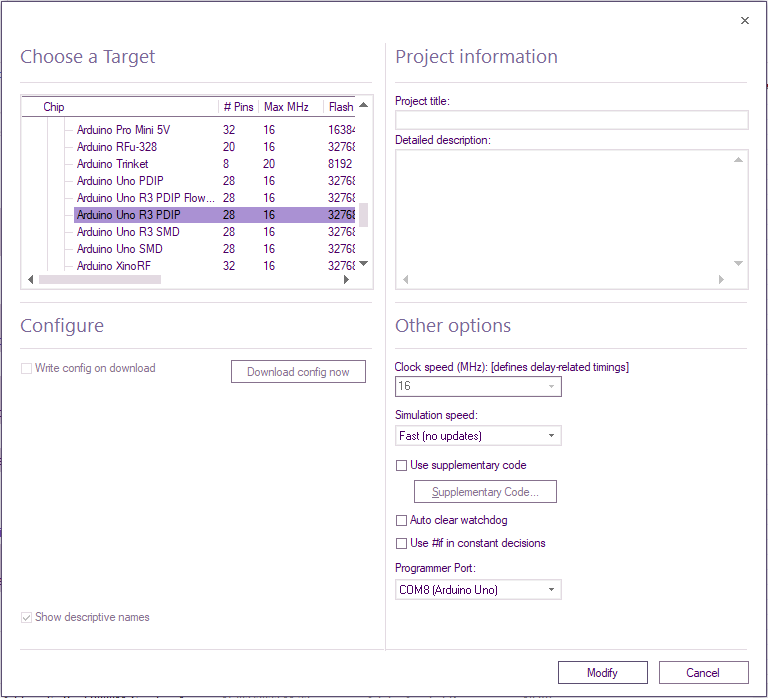

With only the Arduino Uno connected to the PC via USB
If you select Build > Project options, you should have something like this:

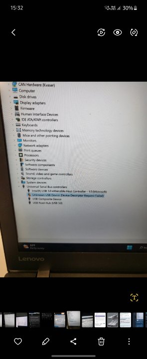

From the device manager. The USB isn't recognised as it can be seen in the picture attached to this message. Does it matter? How do I go about it if it matters. Thanks

Yes, it's vital that when you plug in the Arduino, a VCP (Virtual Com Port) is automatically set up like this: For that to happen you must have the correct drivers installed.
Some Uno's will work straight away as windows will have the correct drivers by default e.g. Dip version
For other Uno's e.g the SMD version, you will have to manually add the drivers.
I believe it's the CH340 drivers.
I have attached the drivers for you to try.

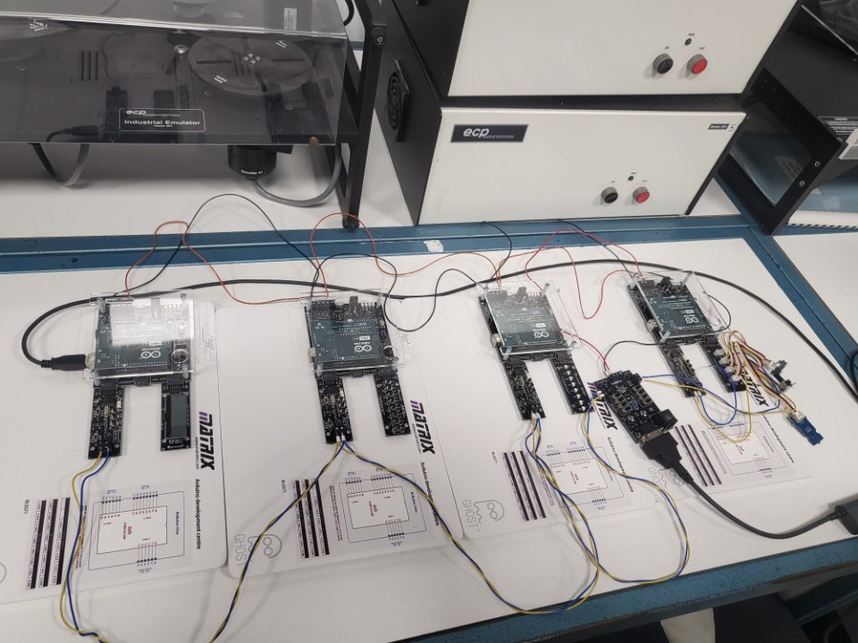

Node 1= lcd( dashboard display)
Node 2 = switch(brake)
Node 3= led( brake light)
Node 4= sensor
Using these nodes to carry out a simple project where when the switch is pressed, the led turns on and also the lcd to display 'brake ON' and also the fuel gauge level when the potentiometer is tuned..
1. How do I go about the CAN ID number, message IDs,
TX and RX buffer
2. How to set masks and filters
3. How to go about configuration of each nodes
Node 4= sensor
TX and RX buffer
