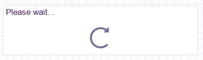

I wanted to import a simple 3D object into the App Developer (just a cube).
It had also taken several minutes. Flowcode was like frozen.
Posts: 2332
Has thanked: 647 times
Been thanked: 856 times
Re: App Developer freezing [Resolved, not freezing]
When importing an object flowcode pops up a window with the import properties. This window often appears behind the main Flowcode window and so it looks like Flowcode has crashed displaying Please Wait.
Posts: 2476
Has thanked: 794 times
Been thanked: 853 times
Yes I have see that and threw me the fist time.
It was as Ben suggested.
The pop up window was behind Main Window.
As soon as I spotted that, it was all good.
