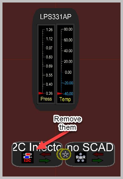

Hi Team.
I received my genuine UNO R3 and all is working well :D now
Is my understanding correct after I did all the HW simulation and testing and want to export my final component I just need to delete the Injector and Scada slave components from the Panel so that they do not get exported as well .
When the user use the component and want to do HW simulation he then add the injector and Scada device of his choice to his project Correct ?

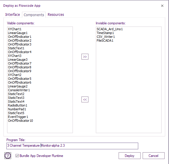

Hi Peter,
That is easily achieved.
After clicking Deploy as Flowcode App, Select the Components tab.
Just select all the components you don't want to appear then click >>
Flowcode app options.png (32.19 KiB) Viewed 6612 times

Hi Martin
Thank you this is good information, I am actually referring to when I made a I2C component in FC and used SCADA to talk to the I2C device during simulation and now the component is finished and I want to export the Component that it can be used in Flowcode so do I delete/remove the scada components or do I miss something from your post ,Thanks for your help Appreciated
:D :D :D
Posts: 2325
Has thanked: 724 times
Been thanked: 783 times
Re: Component Export with Scada
Hi Peter,
What I posted applies to when using an Arduino UNO as a slave being controller via the App developer.
when using the Deploy as a Flowcode APP.
When running the deployed app, anything that was added to the the Invisible components window, won't be seen on the panel.
When you shown remove then, I thought you meant from view.
If that is not what you meant then, my post will not apply.

Hi Peter,
Yes when creating a component source the injector / SCADA Slave is great for testing but once you're finished with the code they should be removed prior to exporting.

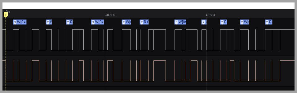

Logic Analyzer print from a Write/ Read operation on I2C at the device with SCADA Simulation :D :D
I am so happy
