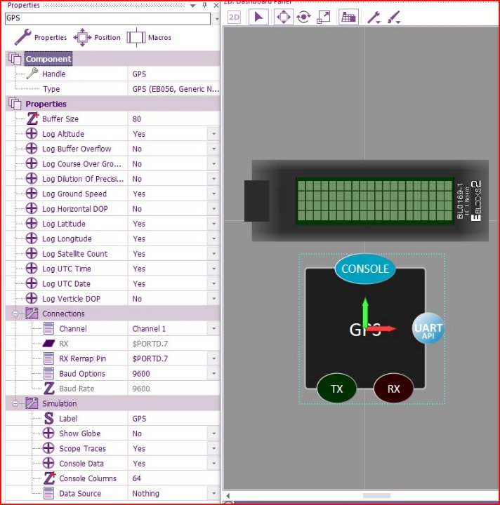

Re: Help needed GPS calculation!
Hi BenR
Thank you very much for helping me with suggestions to get the dsPIC_BL0032_GPS and LCD (BL0169-1.
But I can't see any (Lat , Long) coordinates in the Display.
See the picture below! I have tried according to your description.
But can't see any coordinates in the display.
I have tried exactly according to your instructions but without success.
Yours sincerely
Monie
Yours sincerely
Monie

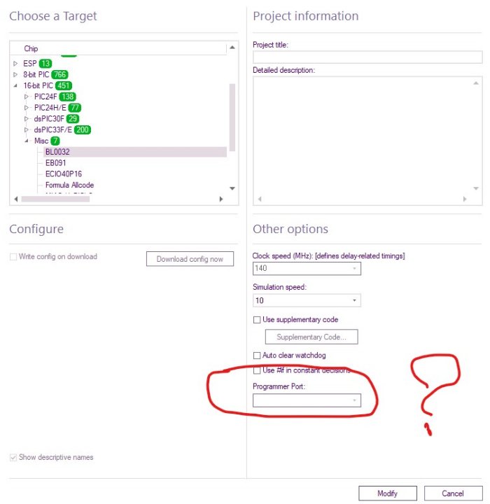

Hello all Flowcode users
I can't find the Programmer Port on the BL0032. Please see below!
Would you be helpful with a suggestion?
BL0032: User: Eblocks2 dsPIC Programmer BL0032-1
Flowcode Test Menu-001: User: Windows v 11
And Flowcode v 10
With best regards
Monie
And Flowcode v 10
With best regards
Monie
Hi Monie,
Please can you follow Chipfriers great advice and if you are having problems getting it to work then please can you attach your project file so we can see what you have tried and maybe suggest things to try.
BL0032 doesn't need a programmer port and so it is greayed out, when you click compile to chip it calls on the mLoader software packaged with Flowcode. For it to work you do need to have the USB drivers installed.
https://www.flowcode.co.uk/old_site/resources/fil ... rivers.zip
I've resized your panel components a bit for v10 and noticed that the connections for the GPS and the Keypad might not be correct.
Please can you go into the component properties and just check they look ok.
