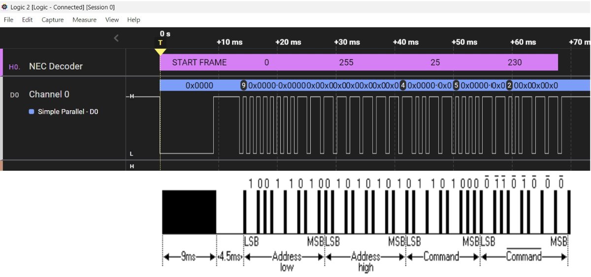

Strange that there isn't a NEC IR component already..
I saw some posts regarding the NEC protocol, but this doesn't seem to be a hard thing to add to FC as a component?
This is a capture of what my logic analyser detects from a cheap Chinese IR remote control.
NEC protocol.jpg (110.17 KiB) Viewed 8413 times
The protocol starts with a 9ms "0", followed by a 4.5ms "1". After that there is the low and high address byte, followed by the data, and the inverse data..
Could there be a component in the (near) future?

I did a bit of experimenting with this - didn't make it into a component though...
Try
NEC PIC2.fcfx
(23.33 KiB) Downloaded 808 times

Thank you very much!
Need to investigate it somewhat deeper.
But a real Flowcode component is something that should be standard already?
I asked ChatGPT and this generates this C code :-)
Could this be something that could be converted into a component?

It would be nice as a component - the Arduino code above should convert fairly easily - but there is quite a lot of work to do (especially if you want to support different MCUs)
I'm very busy at present but if I get some spare time - which MCU are you using?

I'm using an ESP32 right now.
But it's all about timing because it doesn't seem to be such a hard protocol to check??
Posts: 2185
Has thanked: 177 times
Been thanked: 1026 times
Re: Req: NEC IR component
Post by mnfisher »
It should be straightforward - the esp32 is quick enough to make the timing easy. If you want to be flash then you can use the RMT hardware too.
