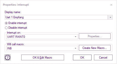

With the old compiler I had warnings about the build rate Uart 1. They have now disappeared
I still have a problem with the Uart1 receive interrupt
Pic16F18877 32Mhz RX Pin RC6 TX Pin RC7
