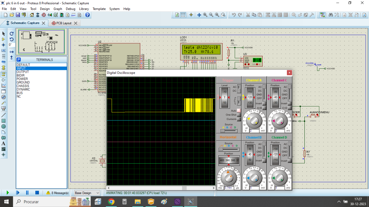

I did what you asked me
the dht22 Grove 101020019 is working correctly both in proteus and physically.
attached screen capture with proteus.
doubt:
In the future, whenever I need to use this component, will I have to resort to Grove 101020019 or is this just until the situation is resolved?
Now we need to resolve the issue with ds18s20/18b20. Thanks for the help.
regards, Adérito
