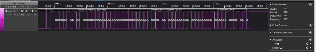

Connecting a Logic Analyser set to decode 1-wire / DHT11/22 provided the following information
Zooming in we can see the sensor actually responded with correct readings
The same results were obtained using v10.
Changing the chart to display results if a "1" was returned (instead of a 0), the chart displayed the correct readings on hardware on the display.

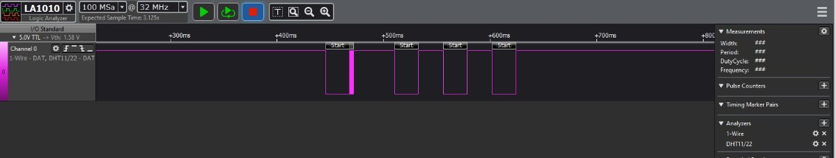

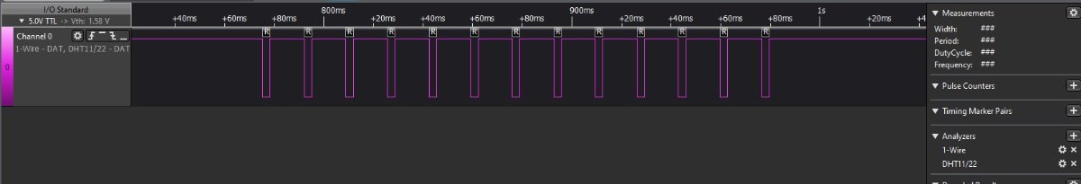

Although still connected to a DHT11, I changed the component to a DHT22 just to see what happens. Whilst I wasn't expecting much really I was interested to see what was being transmitted. The DHT11/22 decoders didn't register anything but 1-wire caught Resets. Same with v8.
It would seem that in both v8 and v10, Flowcode is either returning incorrect values, or there is a typo in description in that it should read 1 for success.
I'm not sure if this helps with your DHT22 issue or not.

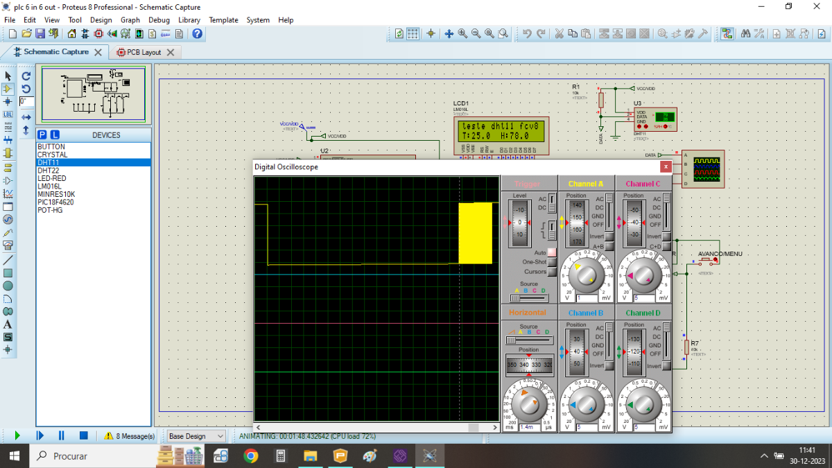

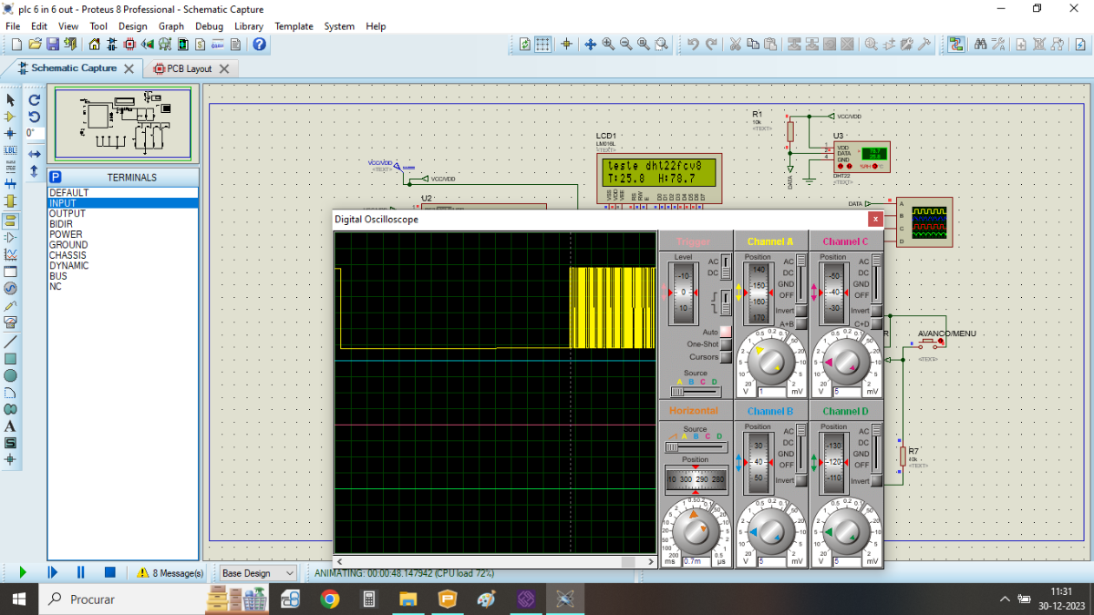

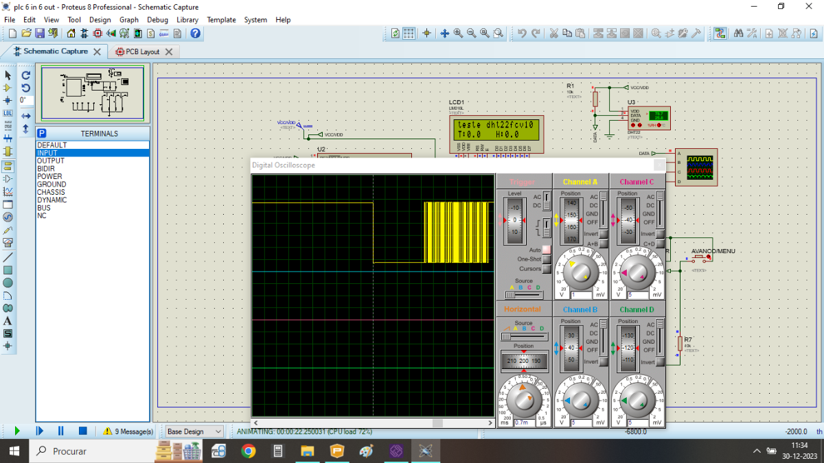

hello,
I took some screenshots during the simulation with Proteus and it can be seen that in the "dht22 fc10" capture the times are somewhat different from the other captures.
I emphasize that the dht11 component works well in both fc8 and fc10
