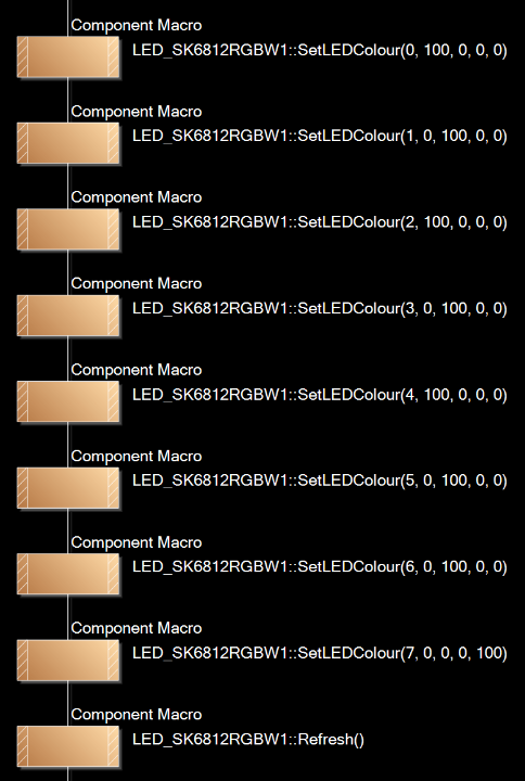

The Led's are working in a way.
But I can not set a led to white.
And the color are wrong.
The colors are swapped not with a system. Some are red, green, blue swapped.
The good thing is....
I can set all led to red if I do it this way
regard
Set Led 1 to red,Led 2 to green,....Led 8 to white
