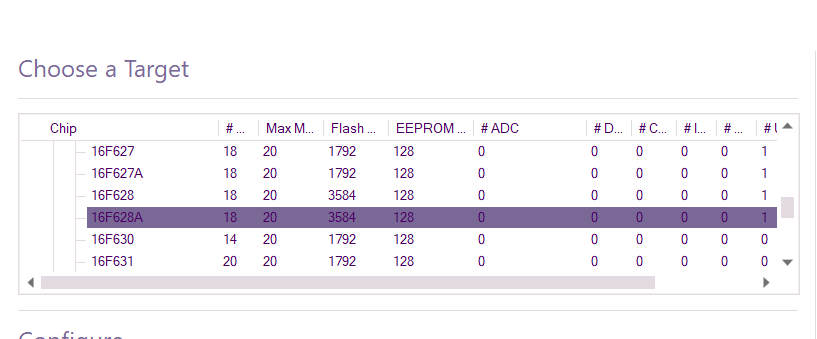

In input components / ADC Input / Potentiometer and Pot Slider , I can't set analog input in Connections at Properties ..I get "unconnected" that not change...so I can't connect input pin of mcu (PIC16F628A) . Any idea on how to solve that? Thanks.

When you choose the target, of 16F628A, scroll along and it will show there are no ADCs available for that target. The 16F828/A has a comparator, which is why you can see AN references.
It can be confusing.
You will need to select a target that has onboard ADC.
