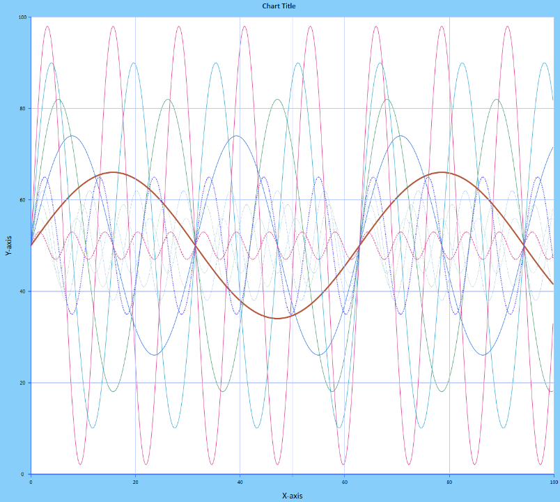

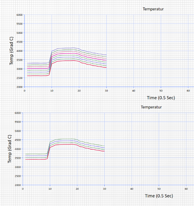

If you need more traces on a chart, then you can use 2 charts as in the attached example.
The two charts are in the same location and one of them has a transparent background, so it will look like there is only one chart. You can use this trick to have as many traces on chart as you want.

Hi Steve
Yes thats working fine.

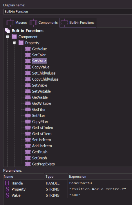

can i set parameters with a build in function (command).
like this example :

I'm not sure. There are dedicated functions to reposition components. What are you trying to achieve?

with a switch the user can choose whether he wants the chart overlapping or separate. to do this i have to change the y position of the chart.

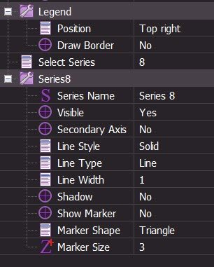

can still ask something unimportant.
Why can I only choose 5 series and not 8?

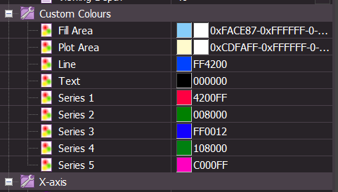

We use a 3rd-party graphing tool within Flowcode for this and that is limited to 5 different colours for the traces. So trace 5 must be the same colour as trace 1, etc.
This can be overcome using that overlapping chart trick. BTW, you could have more than 2 overlapping if you needed. But lots of traces on the same chart can be difficult to view for the user.

A lot of the old object move function calls are not yet implemented for the 2d panel, so I would suggest making objects visible or invisible instead of actually moving them on the panel programmatically. This allows you to be more precise with their positions too. See the attached for an example.
