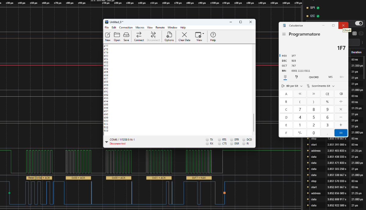

now I have modified as you wrote but I find the master uart output populated by many numbers that do not correspond with those read by the I2C bus

Your terminal program seems to be set to display hex rather than ascii - for example 0d 0a is a carriage return and line feed "\r\n"

in ascii it reads this

The terminal program is either splitting the received data very oddly - or something odd is occurring?

ok I changed the terminal and I read as you read, and from what I see the code already does a conversion of these 2 bytes and probably by increasing the count the third and fourth will join (if I interpreted correctly), but I have to give you a another question, if I send for example 20 bytes to the master, how can I get only 2 or 4? for example the third and the fourth?, or is it better that in the slave they are already divided into registers and then ask for each individual register? (if it can be done)
