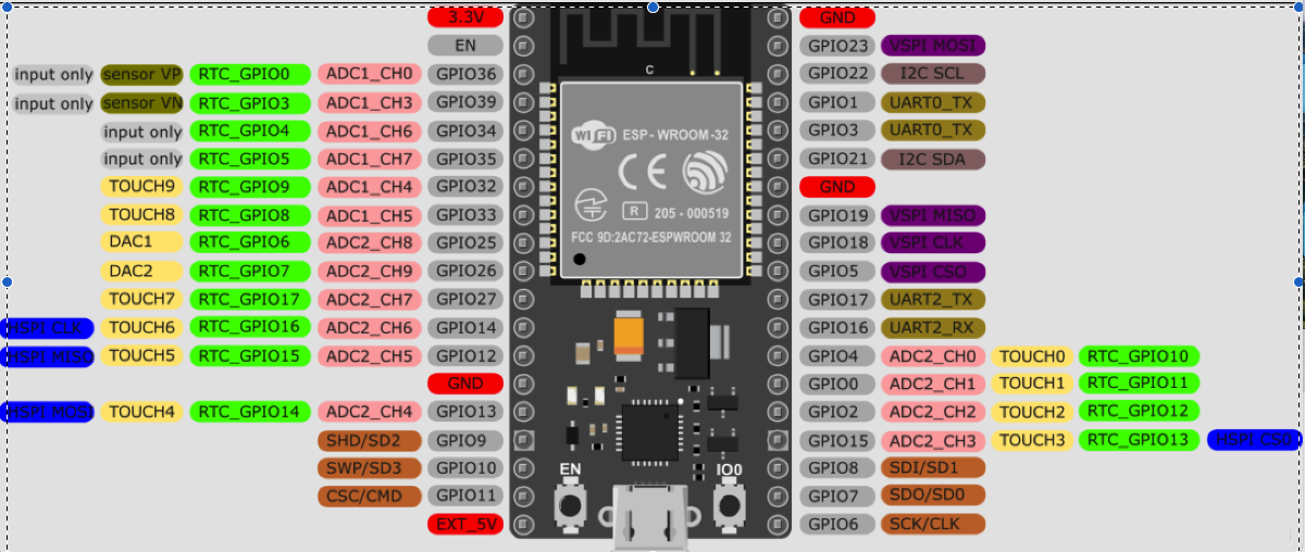

33 and 32 do not exist in the pin configurations in flow code.

32 is pin B0 and 33 is pin B1, hope this helps :D

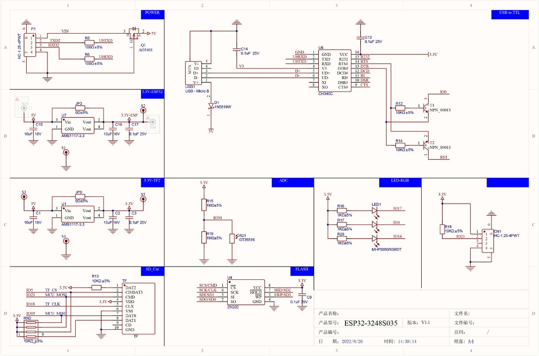

Cool, The documentation sucks, so here is a head start.
LCD: ST7796
MOSI-A.13
MISO-A.12
CLK-A.14
CS-A.15
D/C-A.2
RST- N/A Tied to RST BTN PIN
LED BACKLIGHT -A.27
TOUCH: GT911
CTP_SDA.33 ==B1
CTP_SCL.32 ==B0
CTP_RST.25
CTP_INT.21 * This is shorted to board on my version.
SPEAKER sound -26
CN1 I2C:
SDA 21
SCL 22
Red LED: 4
Green LED 16
Blue LED 17
Photocell An6 / io 34
