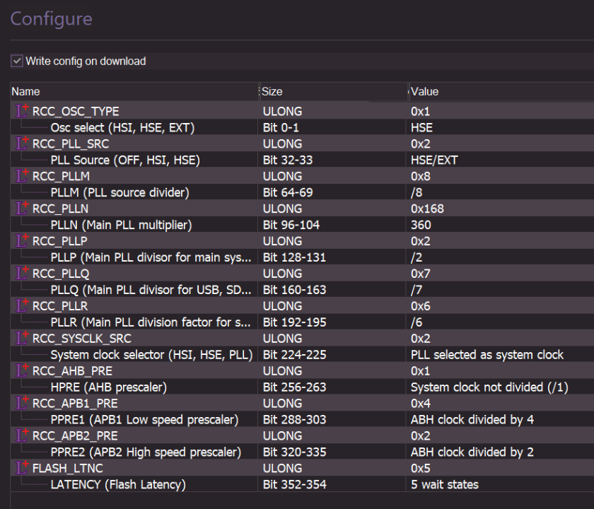

Re: STM32F469I-DISCO Board clock setup
Hi Leigh
would it be possible to add more clock settings?
or can I do this in my program as C code?
These settings here are not enough for the display probably
Post by LeighM »
What extra settings do you need?
What do you think is missing?

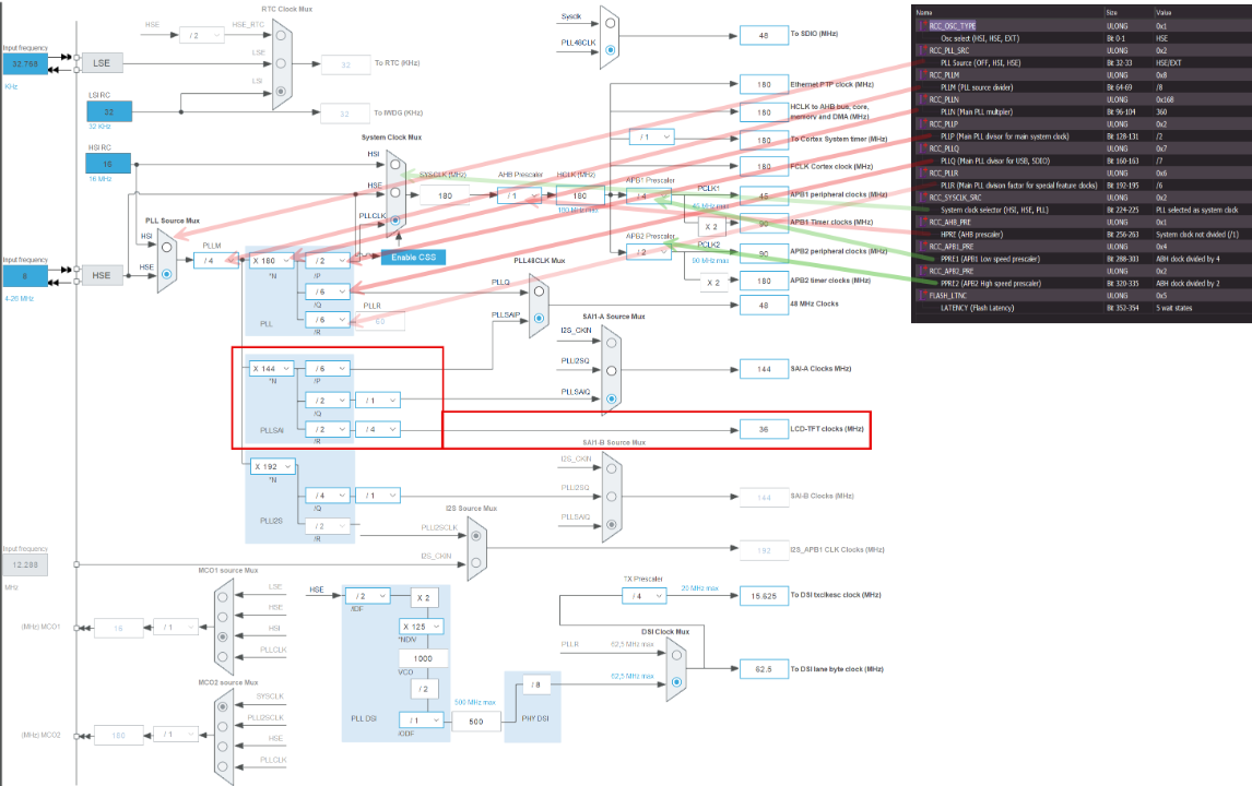

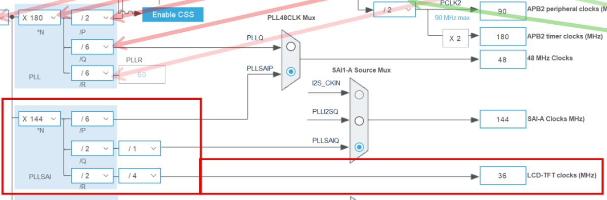

I don't understand how this works but we can test these settings first
already exists
PLL /N
PLL /P
PLL /Q
PLL /R
missing
PLLSAI /N
PLLSAI /P
PLLSAI /Q
PLLSAI /R
Post by LeighM »
Ah, well spotted, looks like that LCD clock needs some attention then.
I'd forgotten that this device has an LCD controller, it's been quite a few years since I worked with this device.
I am still somewhat limited in the time I can put to technical investigations, hopefully someone can get there before me :D
Hi Leigh
I have tried but there is a small problem.
Flowcode10_LCD_Test.c: In function 'main':
Flowcode10_LCD_Test.c:3537:26: error: 'rCC_PLLSAIInitStruct' undeclared (first use in this function)
Flowcode10_LCD_Test.c:3537:26: note: each undeclared identifier is reported only once for each function it appears in
Error(s) in build

Posts: 1290
Has thanked: 246 times
Been thanked: 257 times
Yes compile works,
I have tested different settings
but the display only works correct, if I increase the delay time from 8 to 16Mhz, but then I2c and UART no longer work properly.
I will test the settings again and maybe we should have a look at the reset pin of the display LCD_reset
