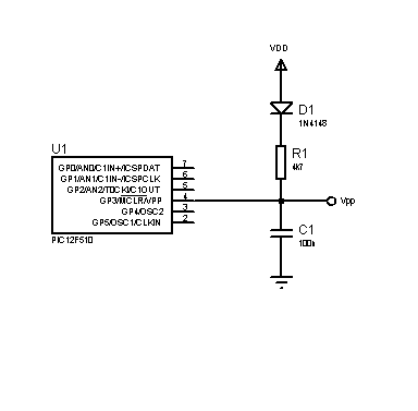

This example works in the simulator. Pay attention to the project options. Do not set "automatic erase". If it does not work in hardware, you will need to restore the calibration constant using a programmer

I was using osccal after I ran out of ideas. I did understand that this was for frequency precision adjustment. For the MCLR bit - I actually have a measured VDD value. It is connected to VDD via a 1k resistor. There may not be a bug, but I have a feeling that the config is not downloading. I'm also a little confused regarding the config settings in FC. The check box for downloading the osc parameters can be checked to download when the program is downloaded. There is a button for "download now", but it doesn't seem to do anything - Certainly there is no indication on the screen that something happened?

I remove this tick and it starts working. If you are programming the chip not from the FC environment but through the programmer, load the file "cof". Try mine

Bit 4 - Enabled. Apply this reset scheme. Configuration word is present in file "сof" 0x3ffa
