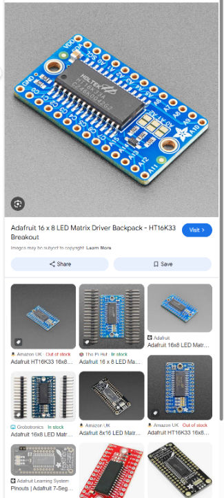

Take a look here....
Choice of:
https://www.adafruit.com/category/88
a variation ?:

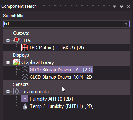

From Flowcode:

so the HT16K33 looks like a good route to investiagte. I see the FC components has been setup for dot matrix style displays. I guess it would need tweaking to suit a standard 7 segment.
I'll have a read of the datasheet and see how lost i get! J.
