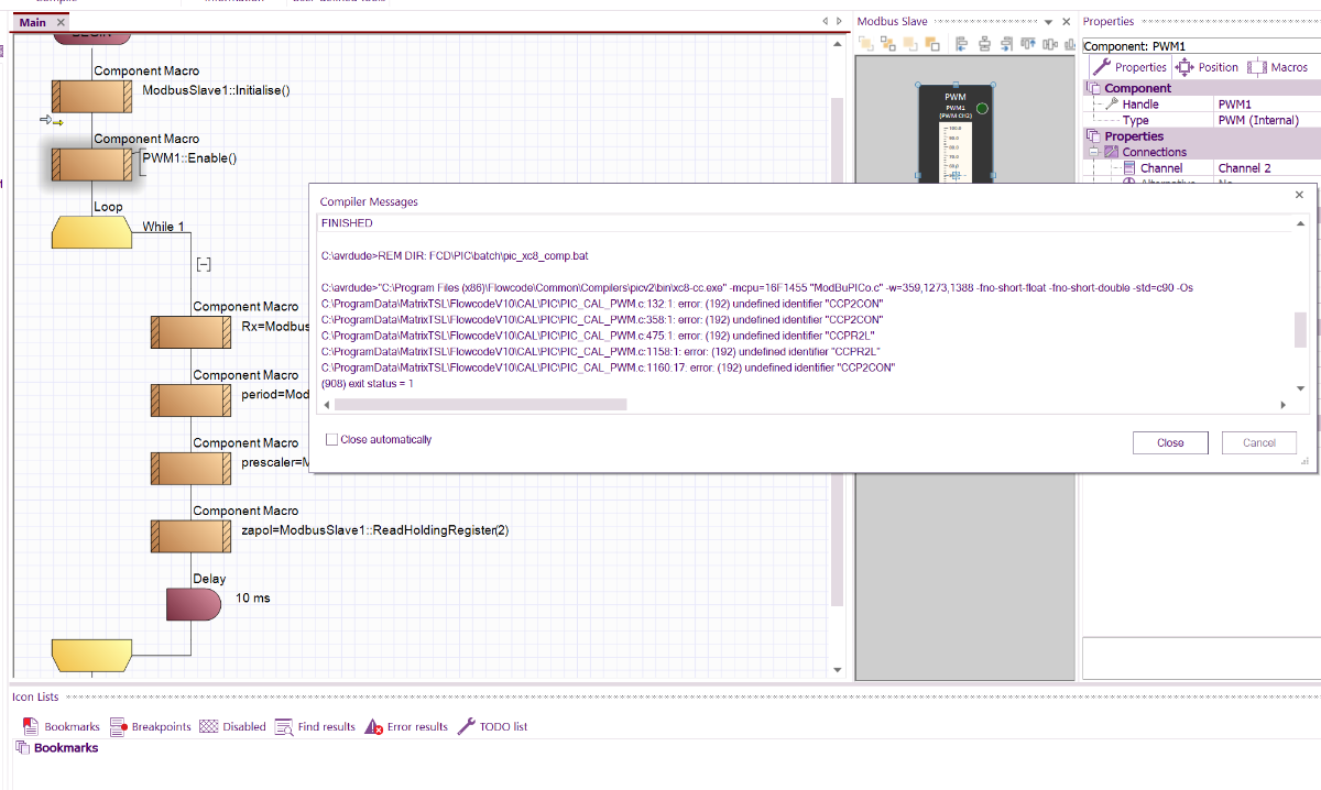

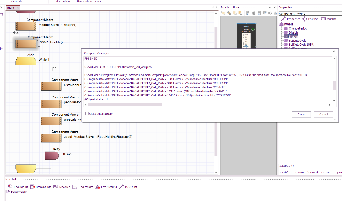

hi, trying to use PVM on timers 1 and 2 results in a compilation error
Снимок экрана 2025-02-14 231508.png (243.09 KiB) Viewed 4286 times
Снимок экрана 2025-02-14 231438.png (243.08 KiB) Viewed 4286 times

Thank you for reporting this issue.
I will investigate and fix the cause of compile failure.

Hello the issue has now been corrected.
Hopefully the updates will be available soon.
When you update your component database, just change Files-in-use to Full database.
