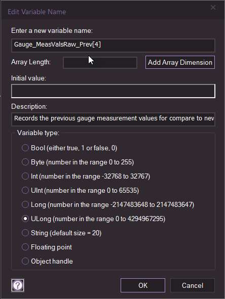

I'm committed to a project using the STM32F407IG MCU, though the project wouldn't build to Hex file and I don't think I'm doing anything stupidly obvious (don't quote me on that :lol: ). I haven't encountered such issues before for other/smaller MCUs of the STM32F407... family.
I then stripped out all macros and components and merely stuck a basic loop at the start of a barebones project, but it still doesn't build.

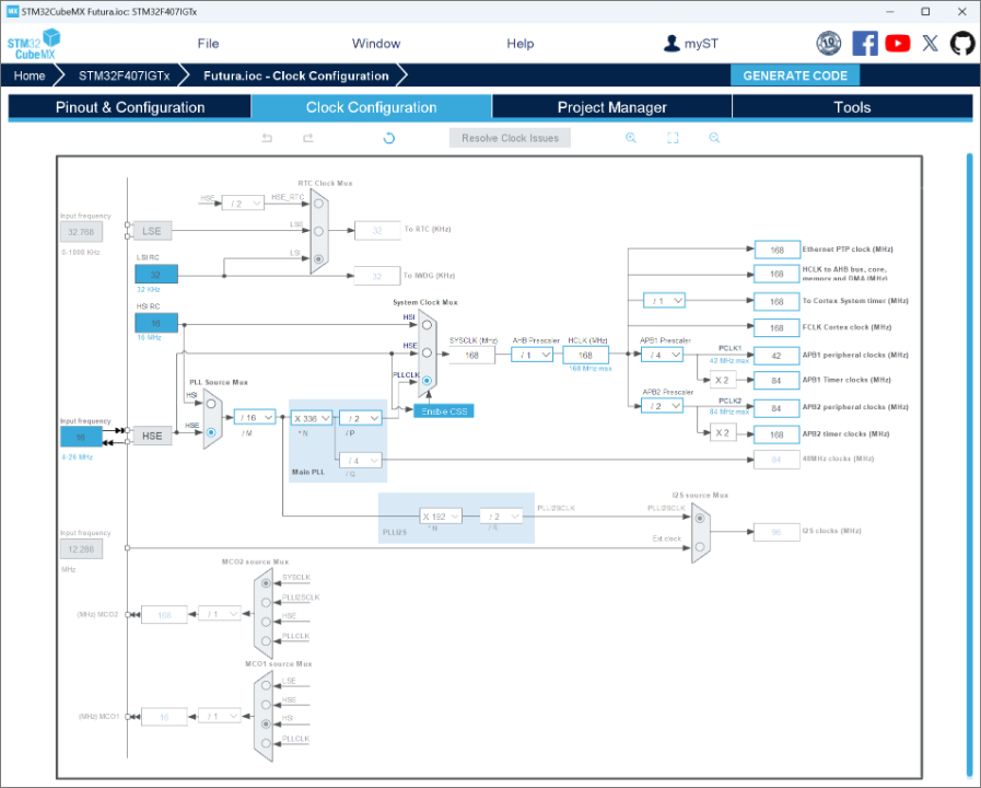

Initialisation parameters in build options are taken directly from CubeMX (without clock issues), leading me to suspect an issue elsewhere.
I provide the basic source project and compiler report for investigation, hoping this is something simple and can be resolved quite soon.

BUILD_ERROR_DEBUG_STM32F407IG.c:74:80: error: invalid initializer
MX_GLOBAL MX_UINT32 FCV_GAUGE_MEASVALSRAW_PREV[FCVsz_GAUGE_MEASVALSRAW_PREV] = 0; // Records the previous gauge measurement values for compare to new

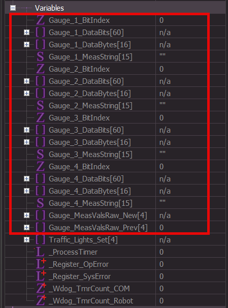

I also get an error
There is a problem with these variables. I have deleted these, then I can compile it

I'll revisit the vars to see if there's anything obvious with them, and a successful duplication and rebuild of the same barebones project and settings confirm what you say.
I suspect something had a hiccup somewhere along the way (e.g. accepted illegal initialiser, or something like that), and thank you again. Entirely appreciated, and a great relief!

I think it's just this initial value of the array. Do not use a value

Indeed, your finding is ahead of me, and aware that arrays can only be initialised using (e.g.) syntax { 0,0,0,0 }, I'm not sure where the single '0' came from, or how that got past the gatekeeper if my own fault.
Anyway, thank you again, and lesson learned for future reference :)
