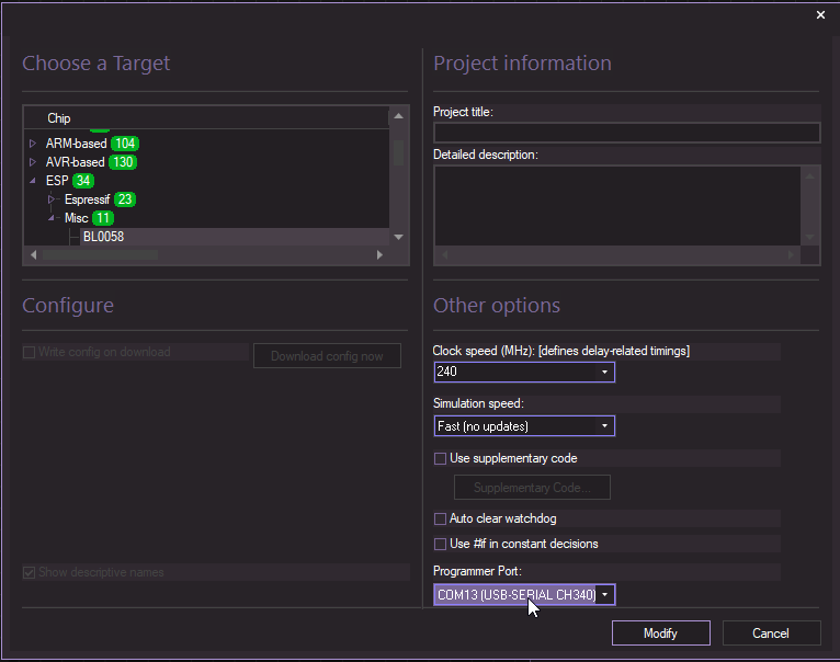

When you connect your ESP32 (not EB0058 board USB marked GHOST) , if you got the correct drivers then a Virtual Com Port (VCP) should be generated and assigned to a COM port.
Check with PC device manager within Ports (COM & LPT) that when the ESP32 board is connected to USB, a new COM port appears, and if it does note the number.

In the above case it's COM13
You then select that number within Build > Project Options, on the bottom right, under Programming port.
Select Programmer Port.png (39.28 KiB) Viewed 3284 times
The Error:
 Invalid value for '-b' / '--baud': 'lolin32_lite_sdkconfig' is not a valid integer.
Is just showing you that the COM port for ESP32 has not been selected.
