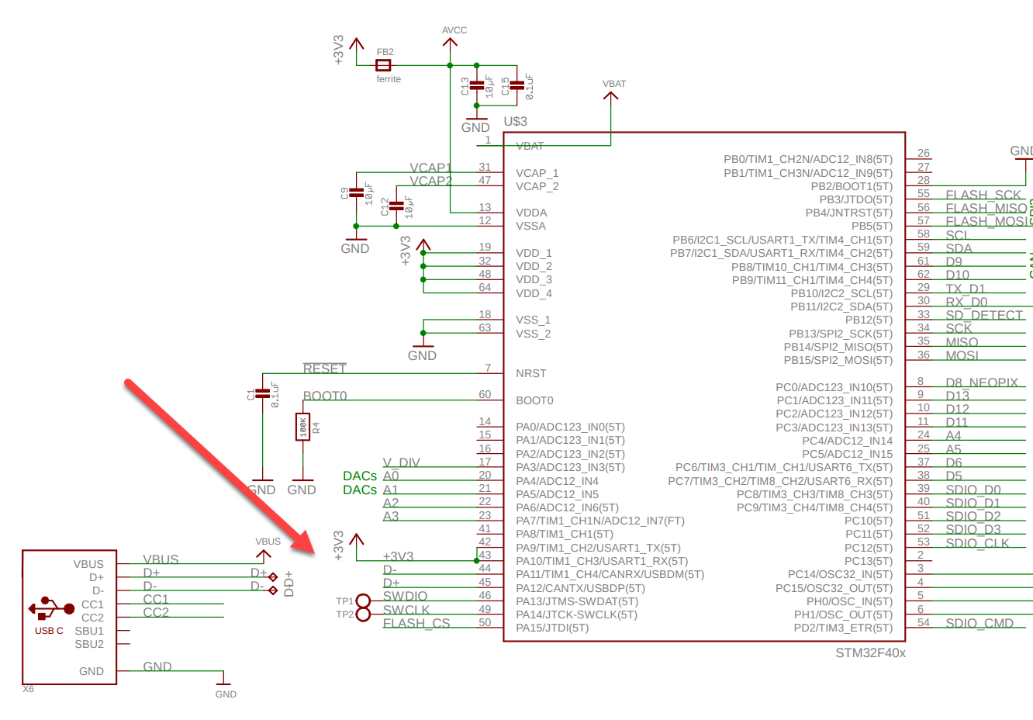

The Board have USB-C connectors and this D+ /D- line goes directly to the STM32F405.
1. Can I use the bootloader from the board with FC10 or do I have to make a detour via an St-link?
2. Can I use the USB-C connection to make a connection to the App-Developer
USB Connector:

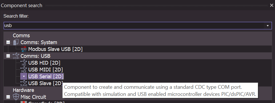

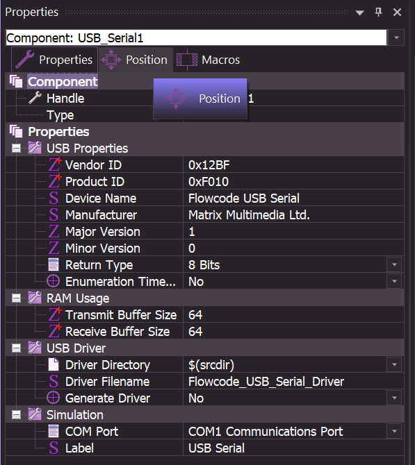

It looks like the USB component is only for selected PIC.
I hope I can somehow send data with the USB-C connector to the App-Developer from the STM32.
Component:

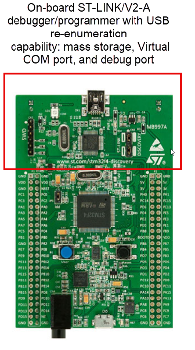

Or you can mail me the bin file and I will flash the new software by drag and drop without needing FC10.
one more good thing, the computer (terminalprogram) with the comport connected to the STM, can stay connected during the flash.
but this is done by the onboard ST-Link/V2A
The ST-Link/V3 is already available and even faster
No.... My board has no onboard ST-Link but I think I can use a extern ST-Link/V3
but I can not use the USB-C to send data to the AppDevelopper. On this board the USB pin goes direct to the STM32 chip
