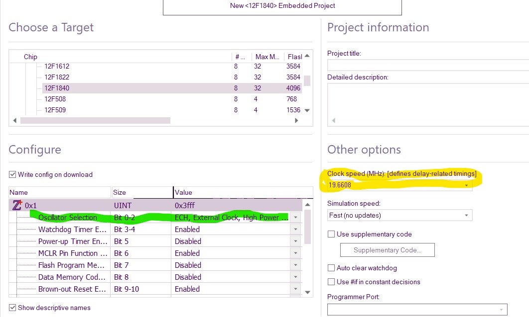

If you mean where you can select clock speed under project options (highlighted yellow) then that only tells Flowcode what speed you are running at, not the hardware. You still need to select that (highlighted green) and possibly add in a C-code block.

If you post your chart we can look further.

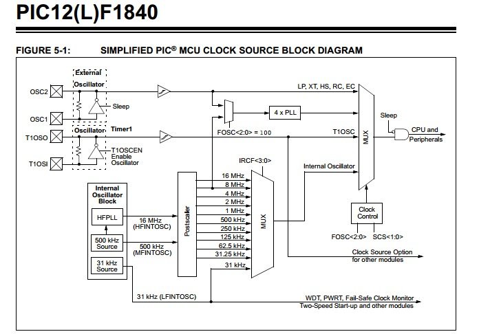

Have a look at the attached snippet from Datasheet. It illustrates the available options you can select using the internal oscillator. If you choose one of them then you should be good. 20MHz would only be an option if using an external crystal.
Flowcode has the Internal Oscillator Helper under Runtime, and this will tell you the code to use in your C-block for your chosen IntOsc, and of course don't forget to set your clock speed to match, under "Other Options" as this tells FC what frequency you are running.
