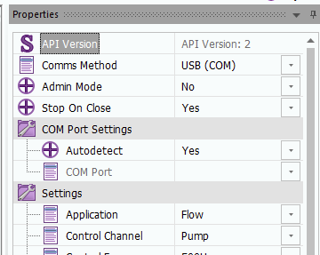

In the source project simply right click any properties you want access to and select Expose to top level.
This basically copies the property as a root property in the project. You can see the root properties by clicking on an empty area of the panel or by selecting the Root component from the drop down menu at the top of the properties window.
You can add categories by right clicking on Properties and selecting New category and then drag the properties around to better organise as needed.
For example here is one of our apps.

Thanks that woirks a treat. J.
