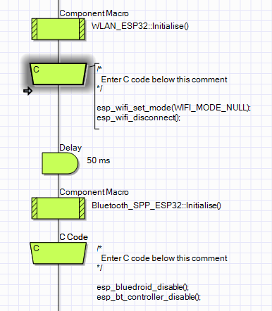

Hello FC team,
if I do a init of ESP32 WLAN and BT component together I´ll get the follwing compiler message.

In between I did a cross check. Only BT init or WLAN init compiles correctly. Both together not like mention before.
The reason why I´m looking forward in order to use BT and WLAN is actually I want to make sure both are switched off. This because I want to save power and more important reducing the risk of 2.4GHZ interfernece by the ESP32. May the concern is that a beacon or so would start.
BR
Dirk

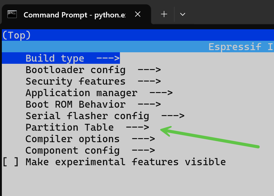

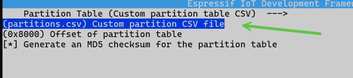

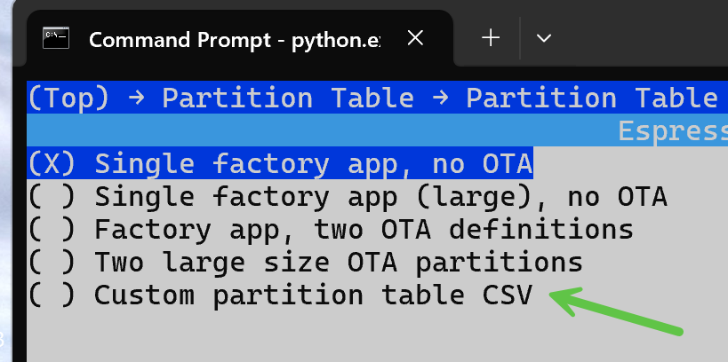

Can do as Ben suggested - or from menuconfig:
I'd used the custom 'route' for creating a SPIFFS partition...
Then select the top row Partition table (single factory app, no OTA) ----> and change to Custom...
Then change the name here if needed:
